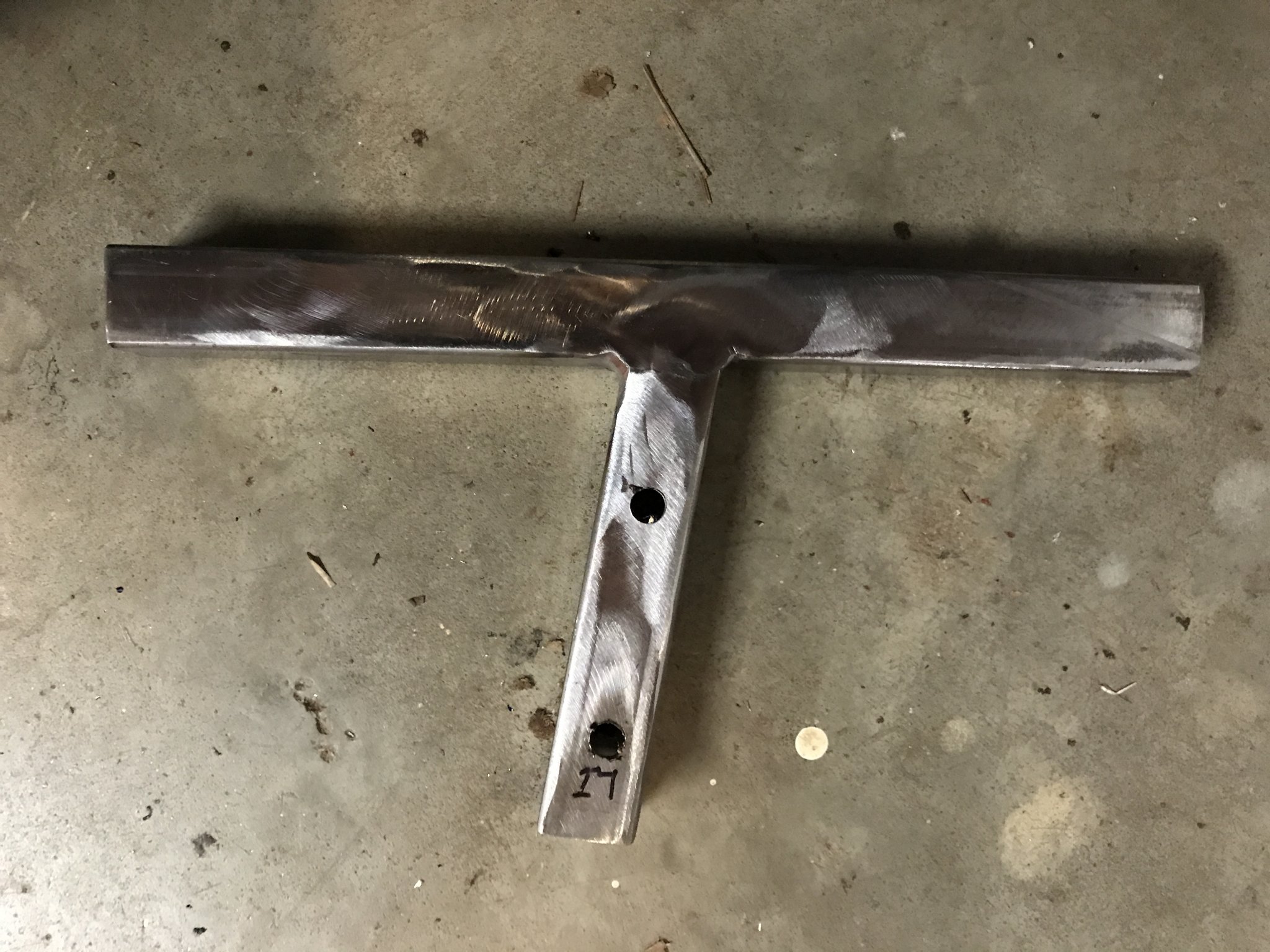

This was easier than I thought. Took some 1" steel box beam and made two like this. My welds aren't very pretty until I grind them down smooth. But I do that anyway for appearance and to check penetration. This one's ready for paint. Didn't bother with primer since I was using Rustoleum.
I used four 1/4-20 TapTite (self threading) bolts to attach this to the ammo can I got from HF. The angle was not a screw up. It matches the angle of the ROPS on my LX2610. One bracket per box, and what fits on the outside on one side of the tractor will also work on the inside on the other side of the tractor. Flip it over, it still fits, but changes which side of the rops it's on. It's designed to follow the centerline of the ROPS. I used Nylock nuts on the bolts, so it ain't gonna fall off. It's high enough to miss the flashers on the cross beam behind the seat, and the grab handles on the fenders.
