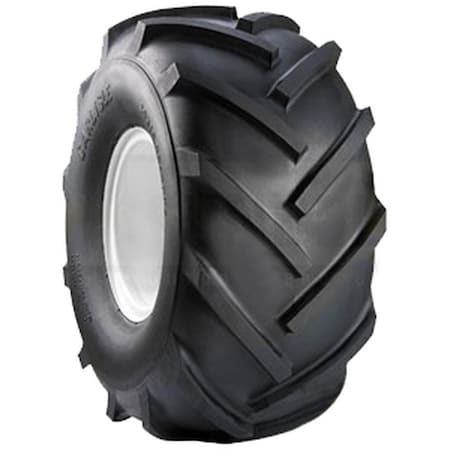

I a relatively new owner of a B2400, and I'm looking at replacing tires. The rear set are the Ag type, and the front are the turf. Current rear tires are 31x15.50-15 NHS. Fronts are 20x10.00-10. According to my manual, I purchased a set of "Ag" style tires that are 7-12, but they look way too high and are questionable if they will clear the front loader. Given the turf tires are 10-wide and the new tires are 12. am I looking at new rimes too?

Good to know about width! But here's what scares me a bitt (see photos). That's quite a difference - and these are the recommended 7-12s.

Yea, if I could actually get those new tires on the existing rims, the tractor's nose would be up in the air :) And I doubt that I could turn the wheels without rubbing the front loader. Hard to say what the previous owner really did with it. Worse comes to worse, I could always put 20x10-10 (or 12) Ag tires on it and call it a day.
