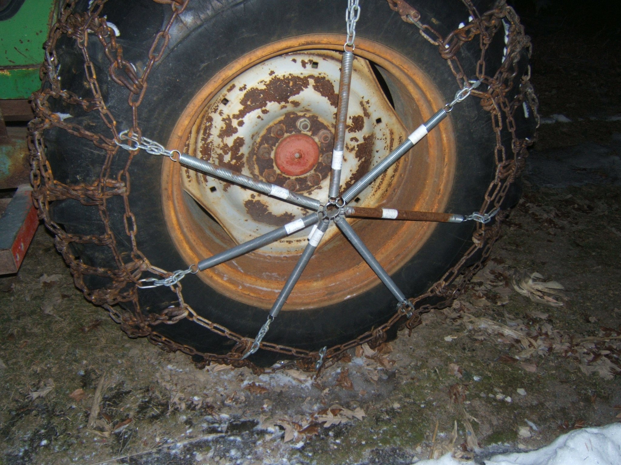

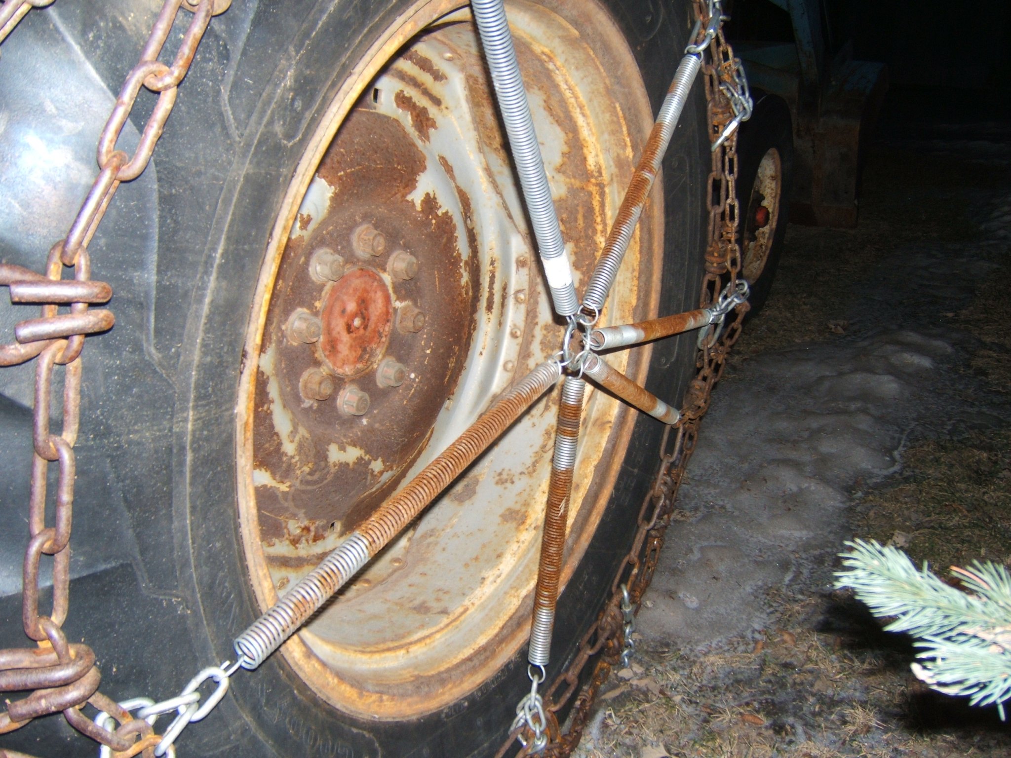

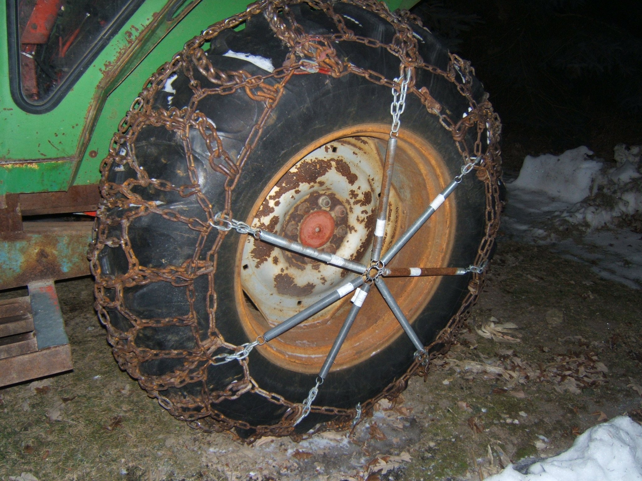

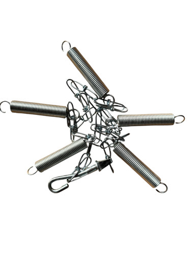

I use a similar system. The center is from a broken bit horse bridle and the spring tensioners are trampoline springs, bought those online, 15 pack a lot cheaper than single springs from hardware stores.
