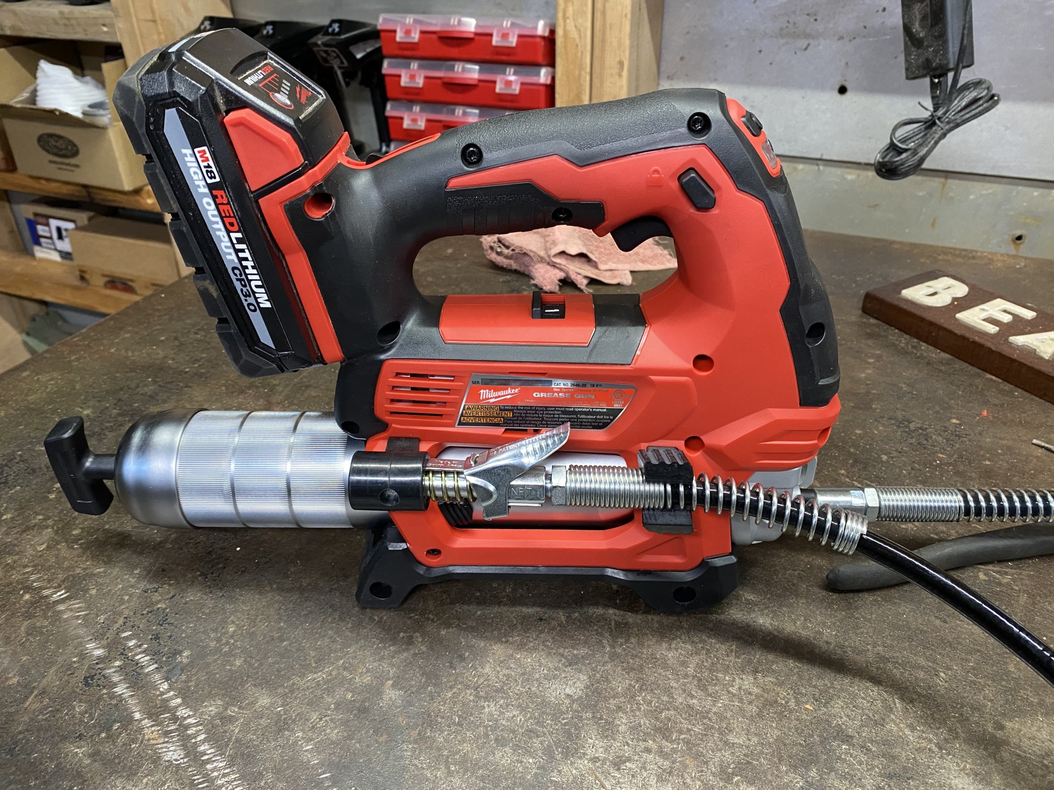

Just ordered this from from Lock N Lube last week. Got the Lock N Lube short tip, the swivel, and a 90° adapter as well. I use Lucas Red And Tacky grease in it. The tip works amazing. Highly recommended.
8,455
4,145
Just ordered this from from Lock N Lube last week. Got the Lock N Lube short tip, the swivel, and a 90° adapter as well. I use Lucas Red And Tacky grease in it. The tip works amazing. Highly recommended. View attachment 68815

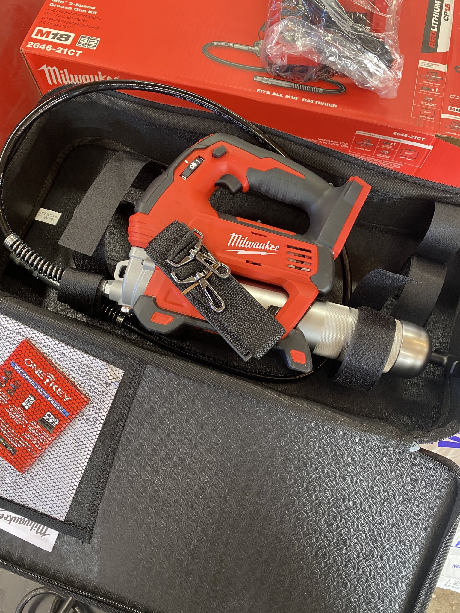

Got a Milwaukee this year also. Wasn’t happy with it at first, but it’s grown on me.
To the OP, I use Red n Tacky exclusively. Like others said, any grease used regularly is better than none.
Very nice! Not sure why mine didn’t come in a bag, i got The bare tool version. But i love It. You need to get the Lock N Lube for it.
