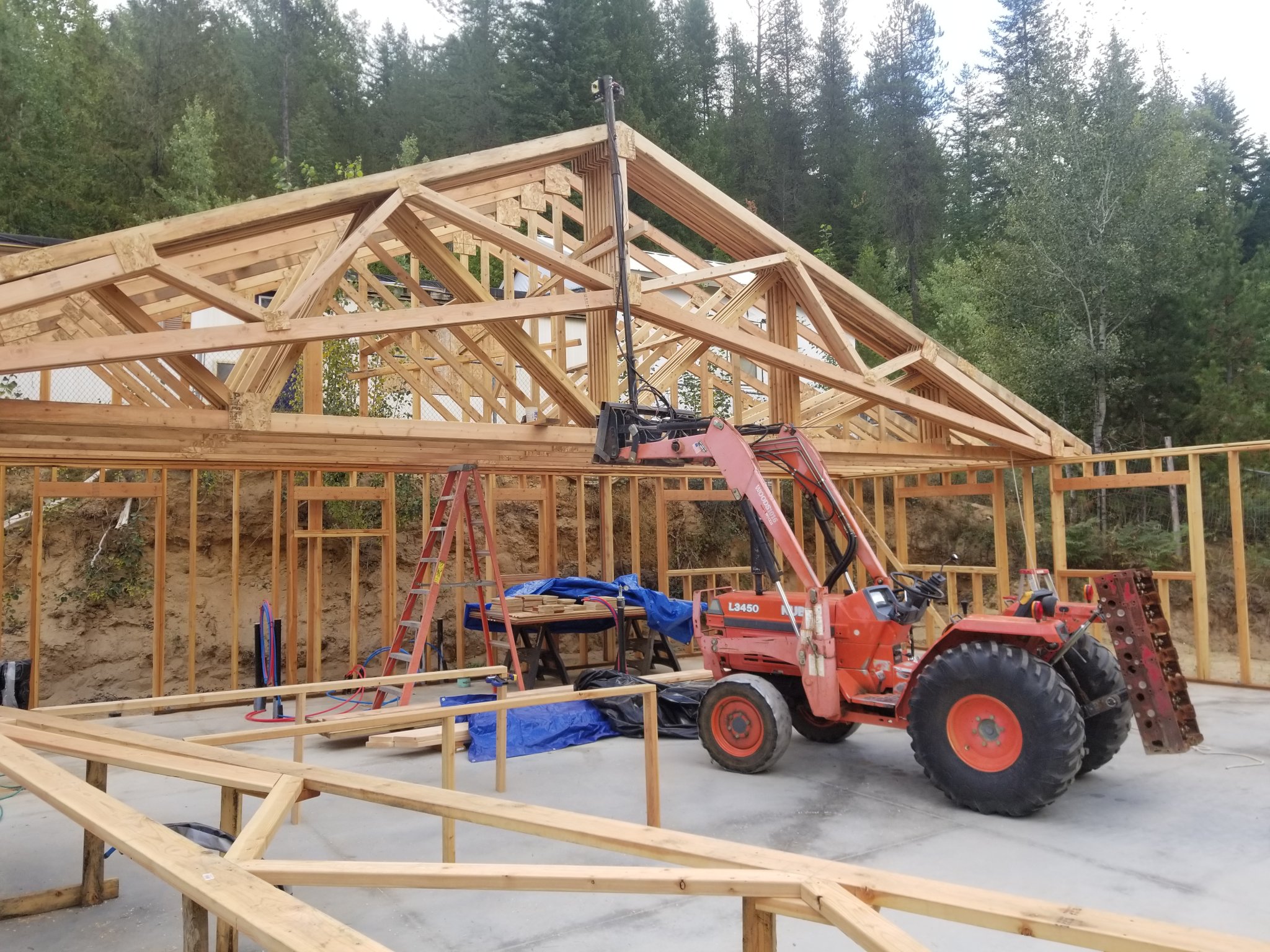

My plates are not undersized they are as large or larger than spec called for.
And calling them chipboard plates just proves you have no clue what your talking about.
North Idaho does not have structural building codes, but still my home meets or exceeds building codes in every aspect.
You do not need " Stamped/approved truss plates meet nationwide codes."
You need stamped and approved truss plans to meet nationwide codes.

In a North Idaho snow load environment, those "trusses" are a very bad idea!
Design may(?) be OK, but connectors are UNSAFE!
Perhaps..... OK in Tucson?
Don’t get your pantys in a wad Fried. We built many pole barns and much of the time we built our own trusses. All of those barns are over 25 years old and some are approaching 60, and that’s in a heavy snow load area of upper New England. You just have to be smarter than the wood you use and know how to build them. It’s not rocket science.

What's wrapped around your front tires? Was it to keep from scuffing the concrete or chewing up grass in tight turns? BTW, nice counter weight.
Yes I made a quick pair of scuff resistant tires with a roll of duct tape. ;)
I didn't want to have the house and garage floors covered in 100's of tire tracks. 😁
