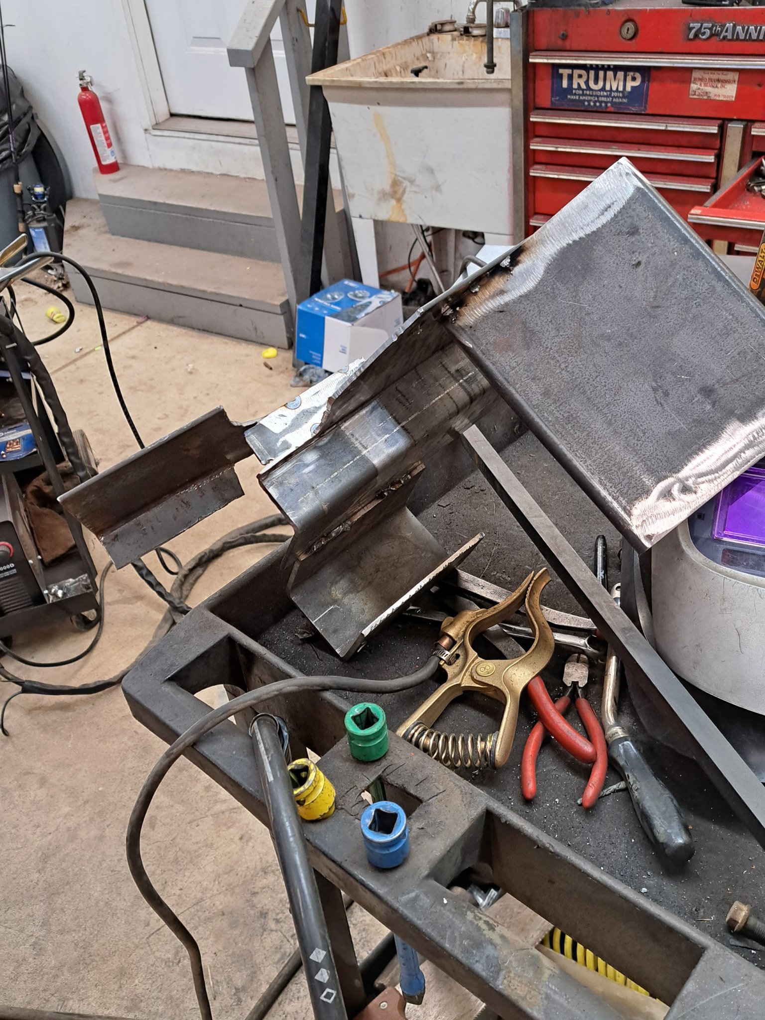

So now its just "fun time" with the TIG machine.
There is no way in hell these "boxes' need this much welding, but I decide to weld every corner that I can, just for the practice.
Its a little tight, but a little tweaking of the torch handle and its fits

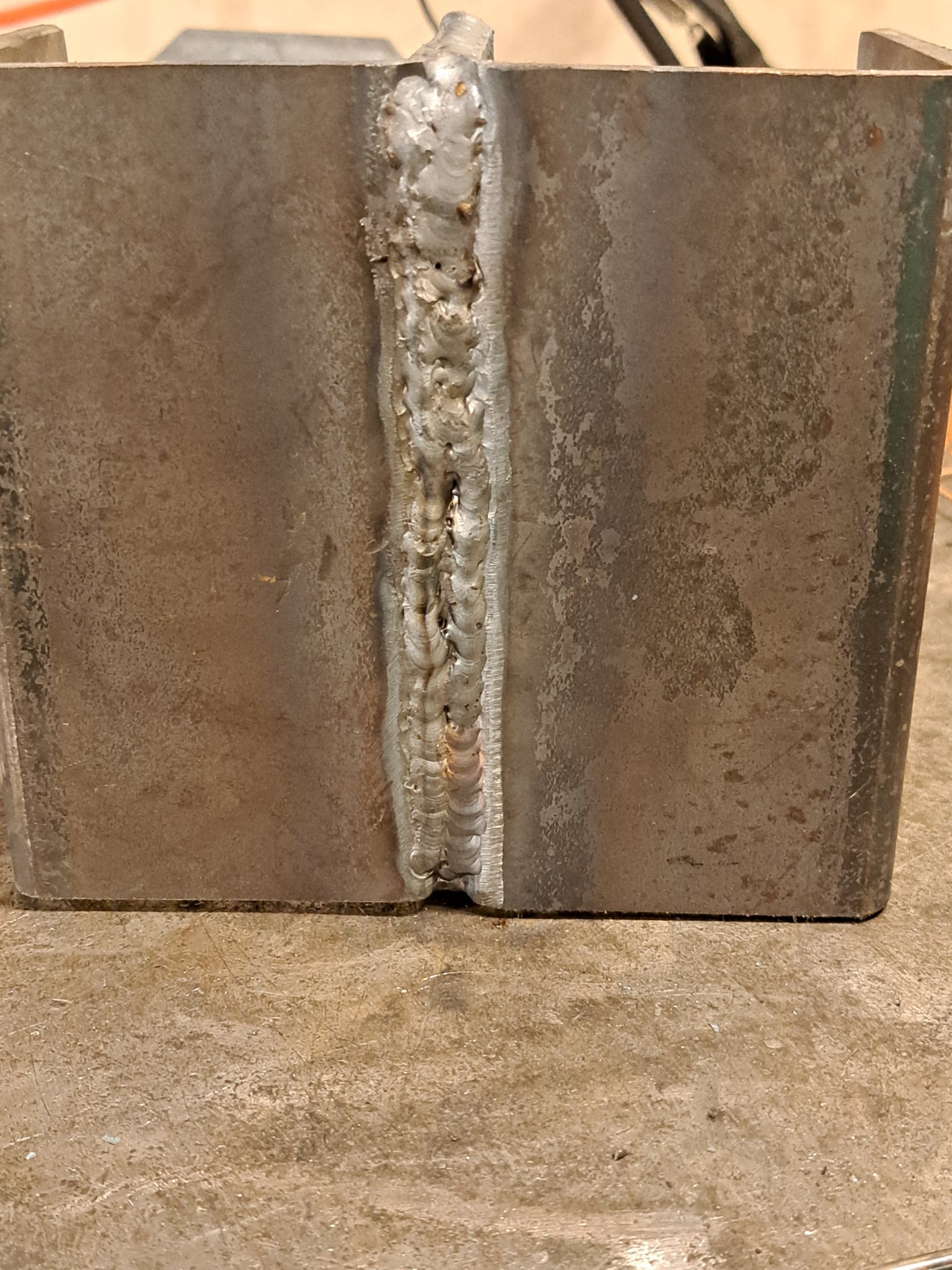

Here is my first weld. I can't figure out why its looking like "hammered dog sh!t'
I mean it's a little tight on the inside of this box, but not too bad...what the.......
Oh yea......You forgot to turn on the gas dumbass!!!!!!
After turning on the gas, it went well, but I must have forgotten to take a pic.

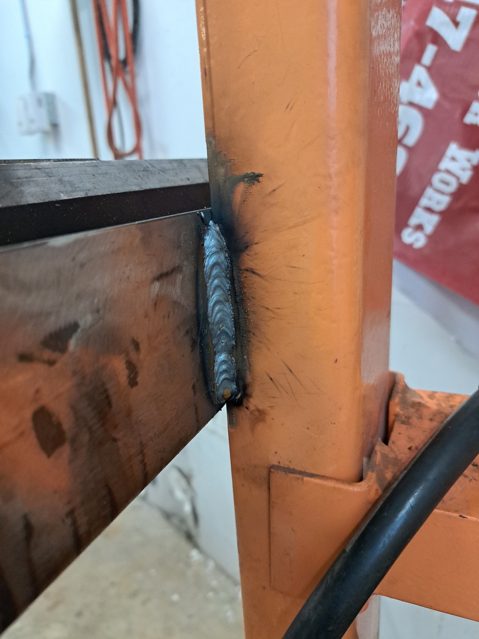

Well attaching them went very smooth, and it was time to practice some "vertical up" with the MIG machine.
Not too, too bad.
It's kind of hard because there is not much to weld, so there is not much time to make "setting changes" on short runs like this, so it becomes a "hope and pray" thing.
And here they are.

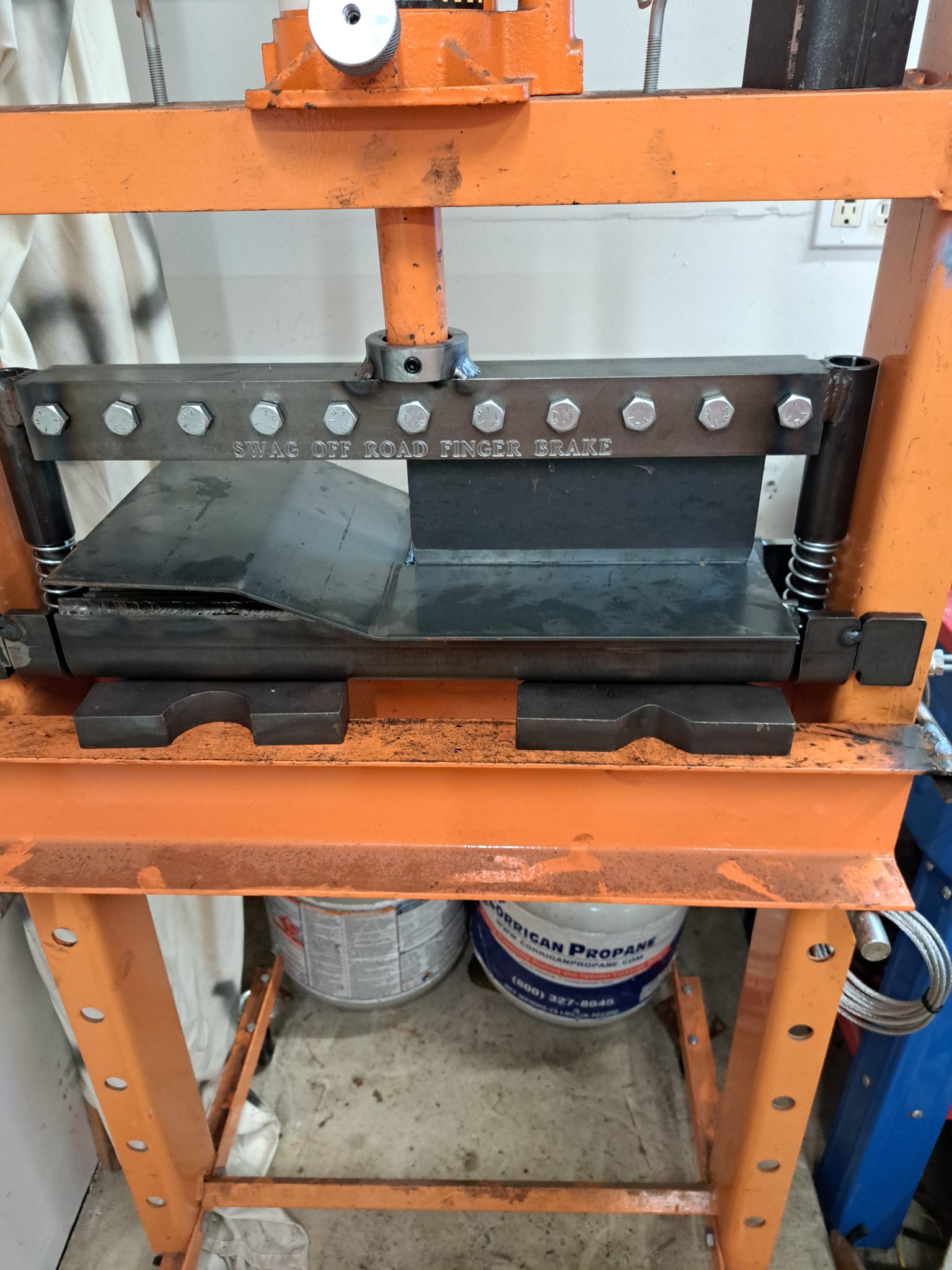

But can you help me understand why you need so many “bits” (whatever you call those things you’re storing in the new boxes)? I can see what you‘re doing with them…. pressing/shaping metal in the press…. but what I don’t understand is why a longer/wider one isn’t useful for short/narrow items to be bent.
1,889
2,006
Enjoyable thread. Thanks.
Thanks, glad you liked it. (y)
Its for bending boxes and pans, and other odd shaped things.
As a matter of fact, back when I was an A@P mechanic, that's exactly what I /we called the brake, a "box and pan brake" but SWAG calls it a "finger brake" very similar concept.
One long "tooth" will not do any good when you turn the piece 90 degrees.
sort of like in this pic, I needed only the one 10 incher. If I had only one long tooth it would have messed up the left hand part of this piece.
The same concept would apply if you were bending up a "3 inch square pan"; You would need a 3 inch wide tooth when you turned the piece 90 degrees.

SWAG does make one with one long tooth too, but for the few extra dollars, the additional "box and pan" capability is well worth it IMHO.
