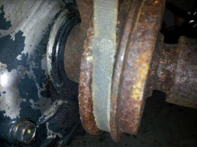

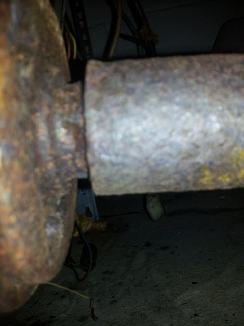

So I uploaded a few pics of progress in the last 2 posts.....I must fully weld up my work to date so if there are any pointers to watchout for tell me quick cos hopefully tonight I'll have it finished.
Now I need some advice please.
In the 2nd last pic you can see the splined shaft attached to the flywheel/pulley on the front of the tractor.How do I get this off.I have tried using rust/freeing agents and lubricants.I have heated it with a propane gas torch and gave it a few moderate thumps with the hammer but no budge.I'm afraid of damaging (a) the alumimium casing on the pulley housing and (b)the casing on the engine.Chop and use a puller on the remaining shaft is the obvious one but I really would like to keep the shaft intact.Please help anyone

no i was hoping that too.its pushed on to the splined shaft and secured by the bolts on the pulley housing so it cant come loose.

Ive had another look.Still looks like the spline must be pulled off the shaft ..no pin or point of separation on the shaft.Maybe removing the pulley will show me more options.

To be really honest, i think you are going to struggle with this one my friend.
There must have been some sort of split pin or similar fixing to keep the shafts together, otherwise they would just come apart, and even if you had a tapered shaft and key there would still need to be some thing to secure it on the shaft.
I have seen three other similar setups on B5100's etc, all of them had a hole through the shafts and then a roll pin or lynch pin through it, but there are prob numerous fittings out there.
I would say you would be better off cutting it off with an angle grinder, rather than keep on getting to heavy handed with it, you stand a very good chance of doing more damage to the end of the crankshaft etc and possible the bearing if you keep on wacking it and heating it up ( been there and done it:( )
Judgeing by your earlier pics with the level of corosion on the tractor, its going to be allmost rusted together and beyond separation.
On another note, judging by the level of corosion on those two shafts, it is very likely that the front pulley will also be rusted beyond repair to the end of the crankshaft, i hope it is not, but all that see air and water does not take any prisoners on this sort of kit.
good luck with it, and i hope you get it sorted, i'd just cut it of now and save any further problems and damage to other parts.

Thanks rob...as i feared so.
I really dont think there was a split pin in this one.I have filed around where the splined shaft and collar join together and there is nothing, not a pin/ dowl /grub screw etc.Which makes sense to as it can't back off when assembled due to the bolts on the aluminium block holding the front pulley.I have stuck in a photo of it prior to dis-assembly.
Non the less you are right, I think its grinder time.I might redesign it so I can have a split shaft arrangement like you have talked about.Would make changing the belt on the front so much easier.

Wow. I have to agree with Rob- I think that is rusted to an immovable lump. If it were me, and I wanted to attempt to save the shaft, I would use an angle grinder with cutoff wheel to split the outer shaft, parallel with the splines, 180 degrees apart. With a little care, you should be able to split it without hurting the inner spline. (might have to use a Dremel up close to the crank pulley)
With it split, you should be able to use a combination of penetrating oil, heat, tapping & wiggling to get it loose. Then you might be able to weld a collar on the split shaft to reuse it if necessary. Did this 20+ yrs ago on an old logging truck PTO, and I think it is still in service.
