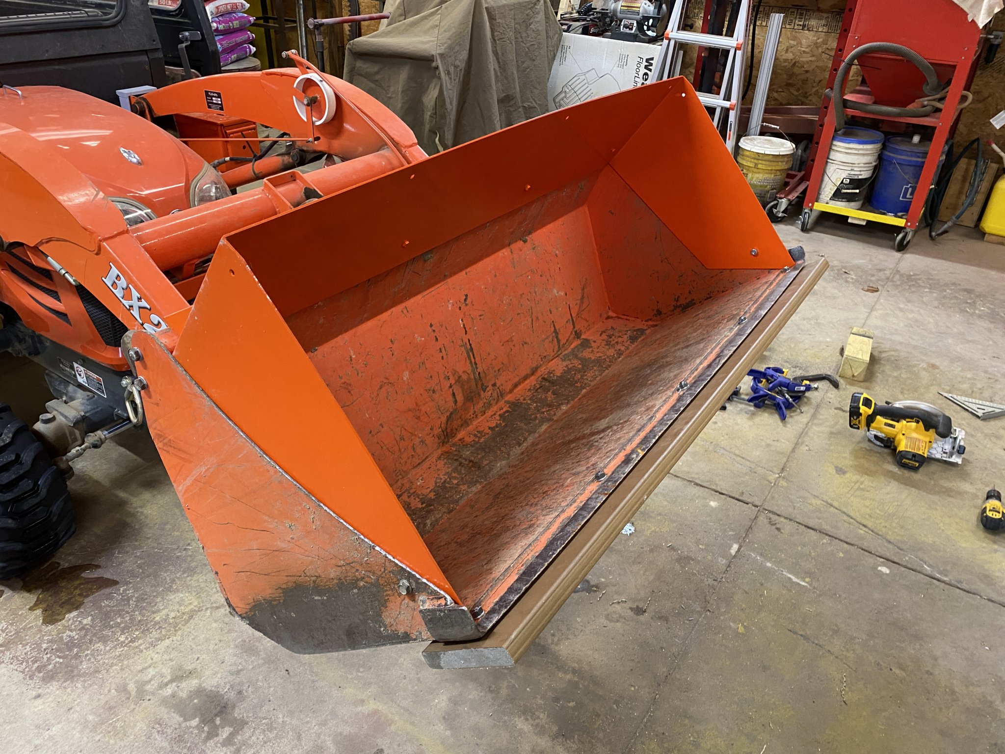

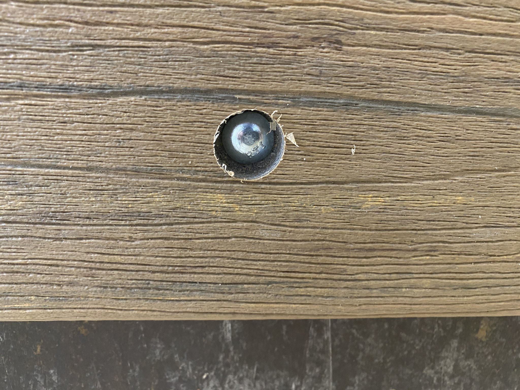

I bolted a piece of composite decking onto the bucket today and scraped some snow off the driveway. I cut 3/8” deep counterbores and attached it with 5/16” carriage bolts. It is reversible so I can flip it around when the front edge wears down. I also bolted on the bucket extension that I made last year.
View attachment 119765 View attachment 119766
