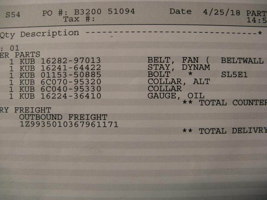

I researched the Kubota USA parts microfiche and in the front after picking what tractor I had, I looked up the "OPTIONS" page. There I found that the 40 amp alternator was an option kit for the B3200. The "Kit" is no longer available but the page that showed the kit gave the part numbers of the parts needed to convert. You have to change to the different engine oil dip stick because the one for the Dynamo won't clear the alternator.

I WILL post my work on the conversion with pictures. The picture show the parts I got from my local Kubota dealer and the part numbers. The parts were just under $100 shipped to me and I am into the alternator for about $100.

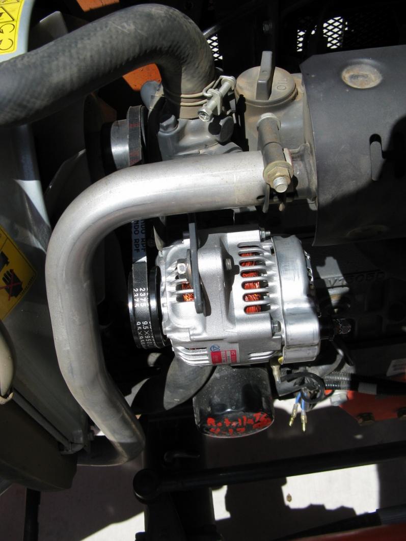

I finished today the alternator conversion. I needed and used all of the parts I listed and they all fit properly. The oil dip stick will be a little harder to get to but the benefits of the alternator were seen right away!
I removed the dynamo, old belt and upper adjuster bracket. Installed the new parts and then the new Alternator and adjusted the belt tension. I ran a #8 battery wire from the Alternator directly to the starter where the positive battery cable hooks up. I took the "T" plug and made up a wire loom consisting of a #14 red for the ignition wire to the alternator and a #16 blue wire for the alternator indicator light.

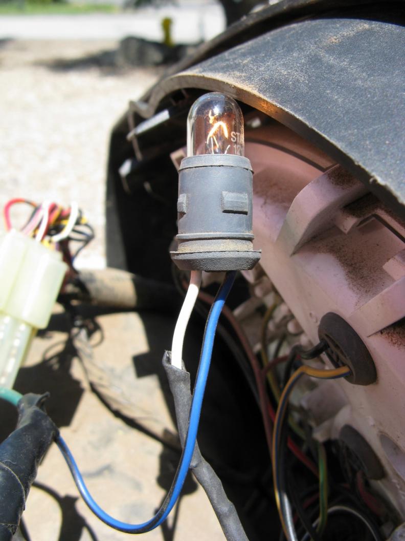

I pulled the instrument cluster out and the lower kick panel. Up at the speedometer cluster, I removed the battery charge bulb socket. My cluster has a blue with black stripe wire and a solid white for the charge indicator light.
The DYNAMO uses a different type of electrical circuit than the alternator does. I carefully cut the white wire leaving about 2" on the socket and the same on the instrument cluster loom. I ran a #16 wire, could use smaller but I have #16 on hand, to the plug where the cluster ties into the main loom via a gang plug. I found a "Key ON" wire which is a green with white stripe on the CLUSTER side of the plug and a red with yellow stripe on the main loom side. On the cluster side, I tied into the green/white stripe wire and added two extra wires, a white and a green. I SOLDER ALL of my connections, even the crimp connectors where possible. The white wire went to the white wire on the charge light, the green wire went to a load relay closing coil I added into the system, explained later. The Blue wire on the charge light, I removed it from the gang plug and added enough solid blue wire to go to the "T" plug on the alternator which triggers the charge light. So now when you turn the key on, ignition voltage goes through the white wire on the charge light and because the alternator is not producing electricity, the blue wire grounds through the alternator. Once it turns and is charging, it cancels the dash charge light.

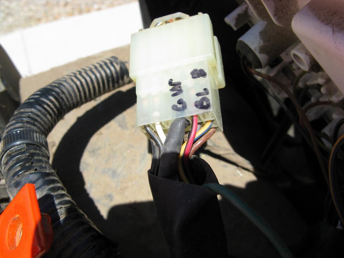

After I unplugged the voltage regulator, I tried the starter and NO-GO. The dynamo regulator has a key switched terminal also and it apparently works in conjunction with the tractors CONTROL box. You will see a jumper on the regulator plug. It jumps from the red/yellow ignition to the white/red which now energizes the control box. WA-LA...I now have a starter and the tractor starts. I double checked everything, got my DC clamp meter on the battery cable and started the tractor. At IDLE, I was reading 6.85 amps. I brought the rpm up to about 1500 rpm and and read 15 amps. I have a battery load meter to load check batteries. I hooked it up to the battery with the tractor running, pushed the load button on the checker and read 12.5 amps going to the battery. This is about double what the little Dynamo would put out.

Very nice work. The dipstick doesn't look too bad at all. Congrats!

I had to do some investigation to figure out the electrical wiring so that took some time on the install. Removing the dynamo and installing the alternator without the wiring took less than an hour. It took me probably 7 hours with investigation of the wiring. I believe now that I would not have had to splice the wire loom at the instrument cluster as with the jumper I put at the dynamo voltage regulator plug, as seen in my picture, would have energized the Battery charge light on the one side. The blue wire from the other side of the charge light would remain as I have it, removed from the gang plug and run to the charge light port on the alternator. I also would have energized the one side of the latch coil for the cube relay at the same jumper.
