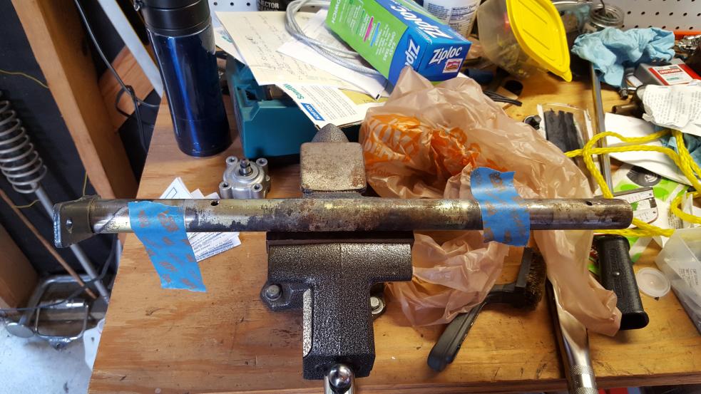

I finally go the shaft out using a torch to heat the cross tube it rides in and using an eight pound sledge hammer to drive it out. It took about two hours to get it out and apparently it must have been stuck for years. I guess the previous owner just relied upon the right break.
The pictures show the cross tube in which the shaft rides and the actual shaft. I discovered that there is only one hole in the shaft where grease moves out to lubricate the shaft. Unfortunately the hole is near the left hand side and grease appears to only get to that side of the shaft allowing for problems across most of the shaft. This was reflected in the observed corrosion on the shaft; less on the left end. The blue tape marked the outside ends of the shaft that run in the cross tube. The brakes and clutch pedals cover the rest of the shaft.

Is the shaft center drilled, or can you drill it further and then drill another greasing port into the shaft?

Glad you got it apart. I know how it feels when something is stuck like that. Polish shaft, clean bore and grease it up.
If getting it lubed is a concern, drill and tap tube where it you think a grease fitting should be.
Many times i have welded a 1/4" nut to screw a fitting onto/ into something.
