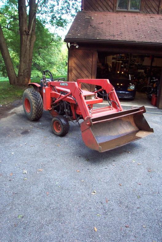

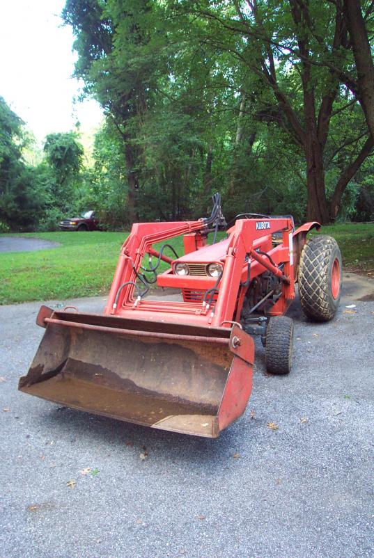

The cutting edge of the FEL bucket is not straight. It's bowed down in the middle. Anybody have any ideas how to straighten it?

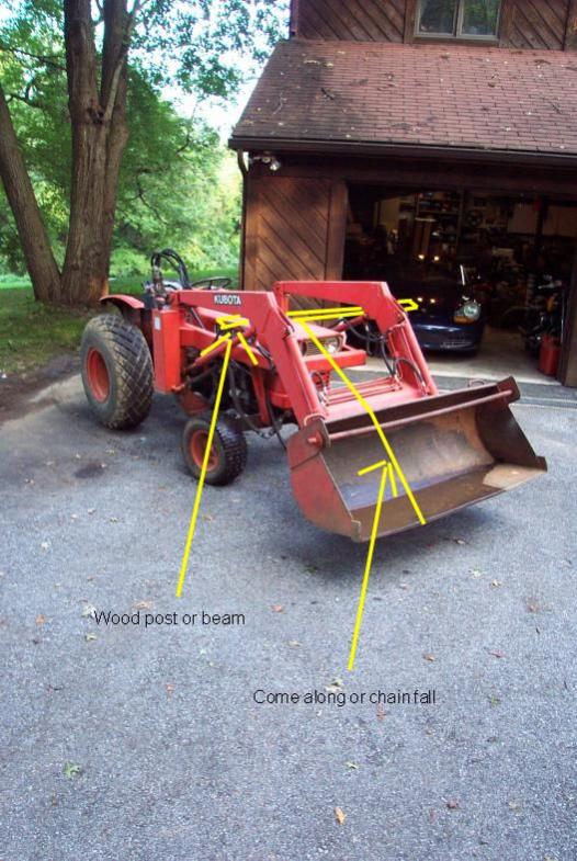

2 easy ways to do it depending on the tools on hand.
#1:
Use 2 10,000lb web ratchet straps and then roll the bucket out.
This method is quick, but be good with the controls and if your pump is weak it might not work.
#2:
Use a beam and a come along or chain fall to pull the lip back up.
This method is slow and easy.
