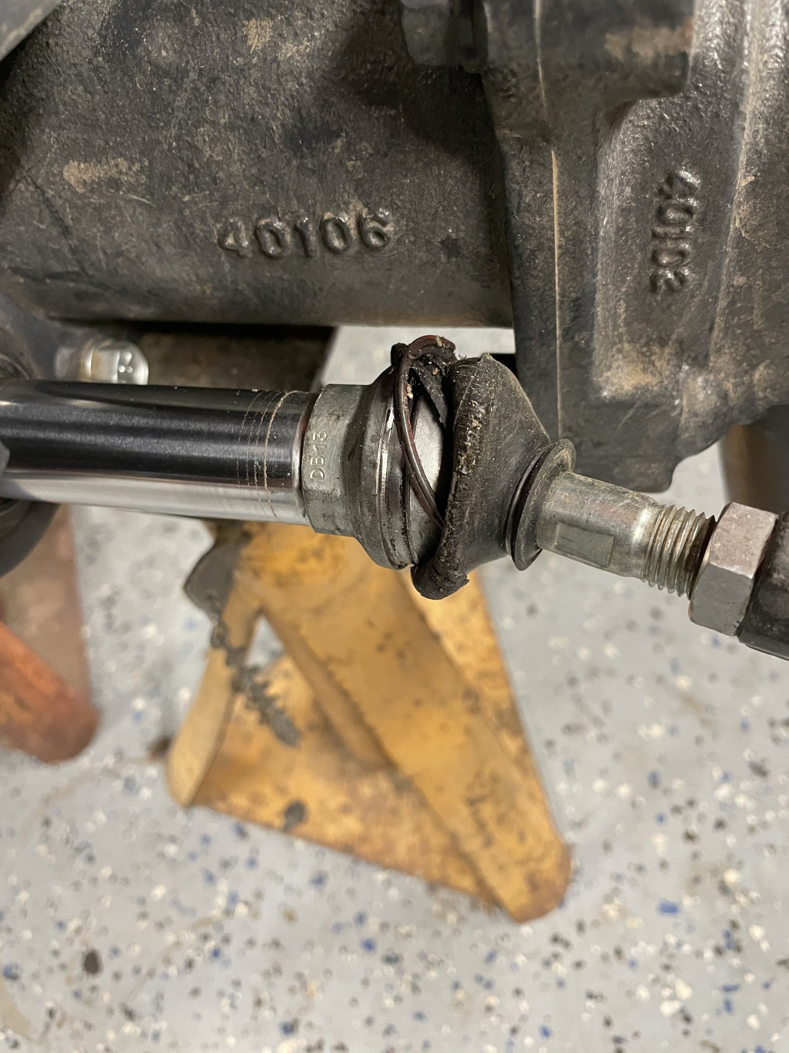

I know it’s been covered many times, and it’s a simple process. But…. It’s one of those things that may get ignored for a time, as it is a minor repair. Just like changing fluids if greasing zincs, if it’s done on a regular basis, it may help make everything else last longer as well. It took longer to find my jack stands than it did to change out the boot.
Yes, I keep parts like this on my Kubota parts shelf, along with other maintenance items.
5,508
4,119
It doesn't take long to change the boot, but if you want to reuse the clip that is OEM by Kubota, that makes the job a real PIA, and you can spend hours just to get them both on.

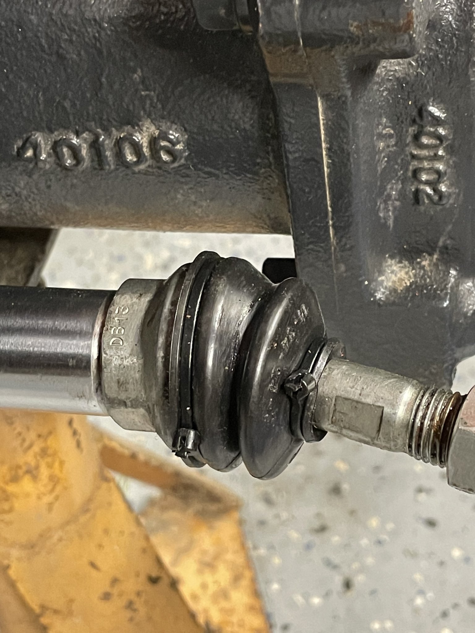

I agree the clip, or snap ring, is crazy hard to attempt to reinstall. They hold great from the factory, but trying to re-install them just “ain’t gonna happen!” I ended up using tie wraps. I put the snap rings In The parts zip lock bag with the spare boot.
If I use the other spare boot, I’ll tie wrap that one too
