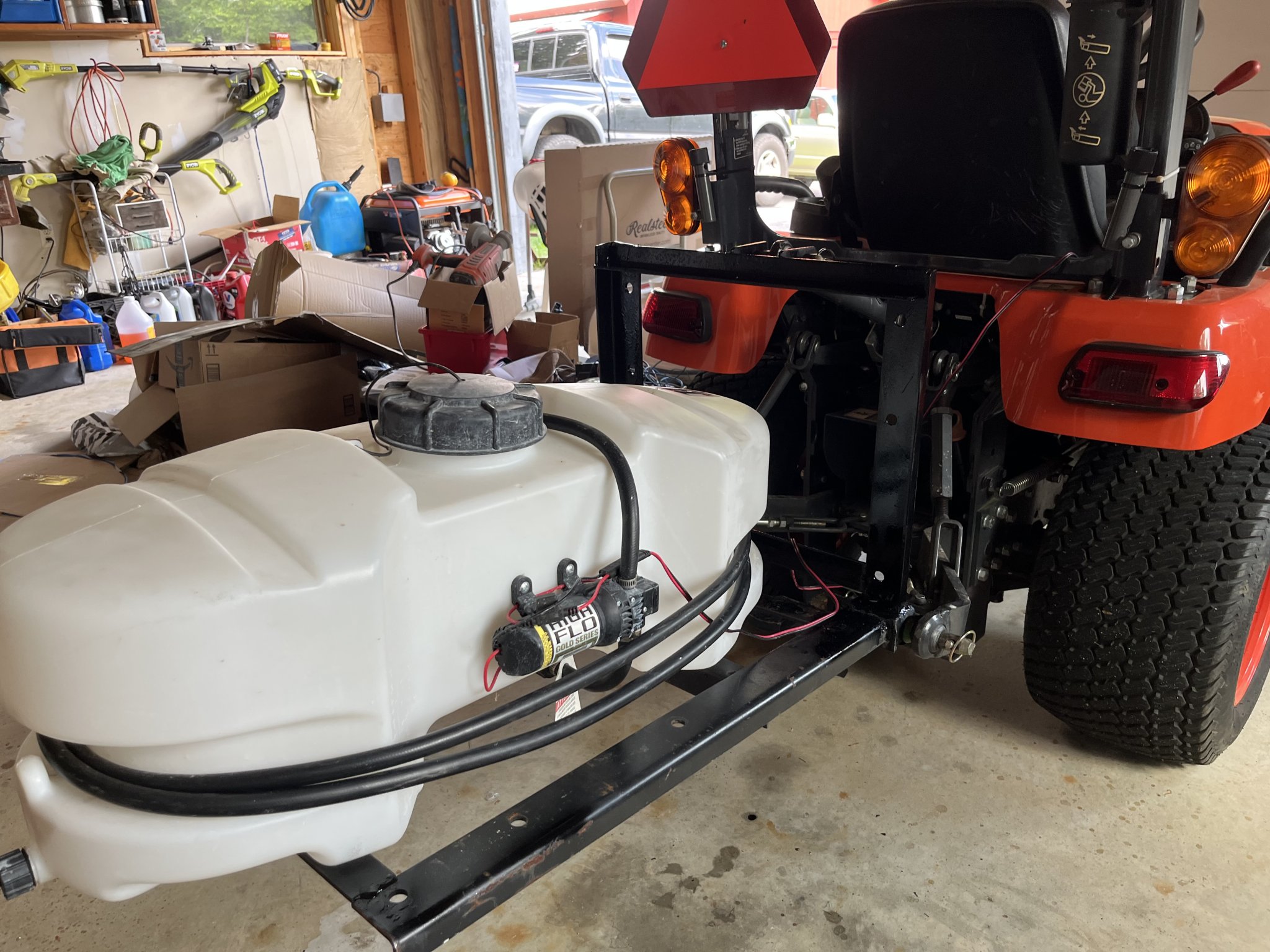

I have a few apple trees and spray them with Kaolin Clay Powder mixed into water to drive off the Japanese beetles organically.
The 15 gallon sprayer was carried around in a small trailer but recently I decided it needed a dedicated frame for my BX’s 3pt hitch. I mounted the tank longitudinally so I can agitate the contents by heel and toe on the HST pedals. Everything but the pins came from two scrap metal frames that came as shipping brackets on my garage lift. 2 hours and done!

Much better than a trailer mounted sprayer. I did something similar after jacknifing (and cracking) the tank on my tow-behind. Being a part of the tractor makes it a lot easier to maneuver.
Mine has a short pair of arms with spray nozzles that fold down for use, and valving to choose between the nozzles and the gun.

nicely done!
I do similar with a portable 3pt generator.
handy, easy, convenient all comes to mind.

OP, can you partially open the recirc valve and let the pump run to keep your stuff mixed? I guess this is what I occasionally see on apples from the store?
