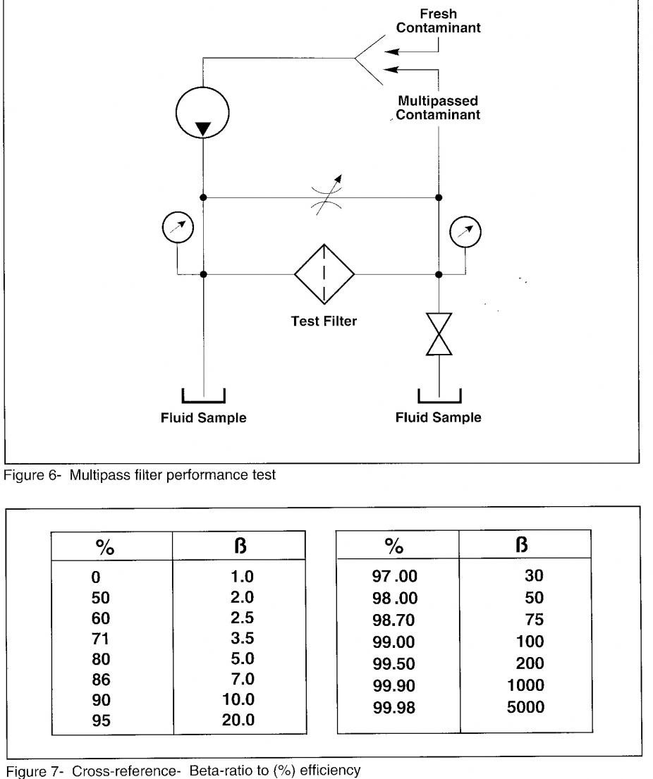

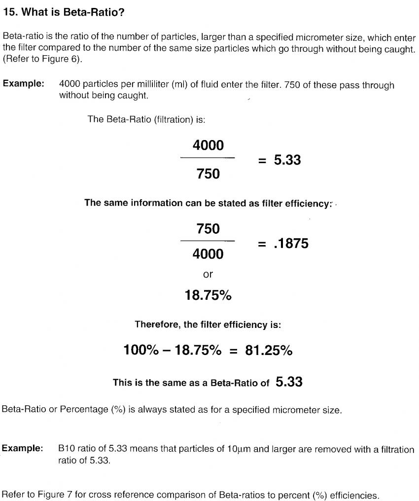

Milo you are on fire with great ideas! Here's a thought with your latest project... in my business, ( Aerials ) we don't use any return filtration smaller than 20 Microns. There are several reason based off of particulate size and harm to the system why we have found this level of protection to be a happy medium. PLease find attached a couple simple formulas with a diagram for thought while deciding your needs. :)

Interesting charts, what volume of contaminants were introduced into the tests?

Ah ha....:D I would be giving up proprietary info there, but the diagram is a very simple diagram of a test filtration system that can be used on both pressure or suction. A fixed pump with a variable flow device, parallel Compound gauges and separate fluid tanks one of which has a shut of valve. The idea is to cycle the system with different levels of contaminates induced into the system and measure the wear your components see during the beta testing. Beta testing is a term used in the development of prototype system analysis in several manufacturing disciplines. Thats about all I can offer on the subject. Its nothing more than a simple flow system used in Beta Testing. There's a whole occupation ( Job Title ) for Filtration Engineers whose goal is to clean the fluid to a point that abrasive (Contaminates) are not factors in the catastrophic, degradation, or intermittent failure of all the components in the hydraulic systems useful life cycle of the maintainable performance. Hope this helps....:)
