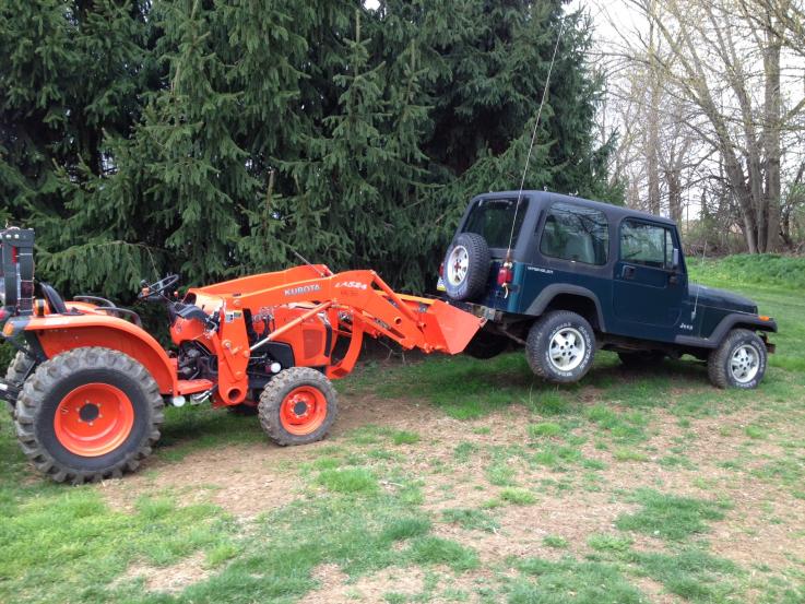

I don't know how many pounds my loader will lift. but here'a a picture taken not long after getting the L3200. Tired are filled and there's a heavy mower on the 3PH.
