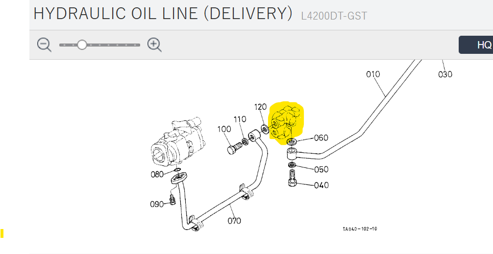

You need to understand the operation of the hydraulic system if you want to troubleshoot it. Thee output of the pump is sent to a hydraulic outlet block on the right side of the engine. The selector valve on that block controls where thatflow goes. Since you have a loader you want the slot on the selector to be in the vertical position which sends the oil out the "B" port to the loader valve.
Picture of the block and how it operates below. Make sure the selector is in the vertical position. Follow the hose connected to the "b" port up to the loader valve and disconnect it from the valve. Stick the open end of that hose inyour 5 gallon bucket and repeat your test. The oil sucked in by the pump should be returned via the hose.

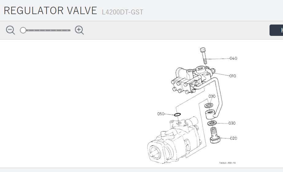

Loosen these 2 banjo bolts and put a bucket under each
First banjo bolt is the GST feed it's right on top of the pump attached to the regulator
