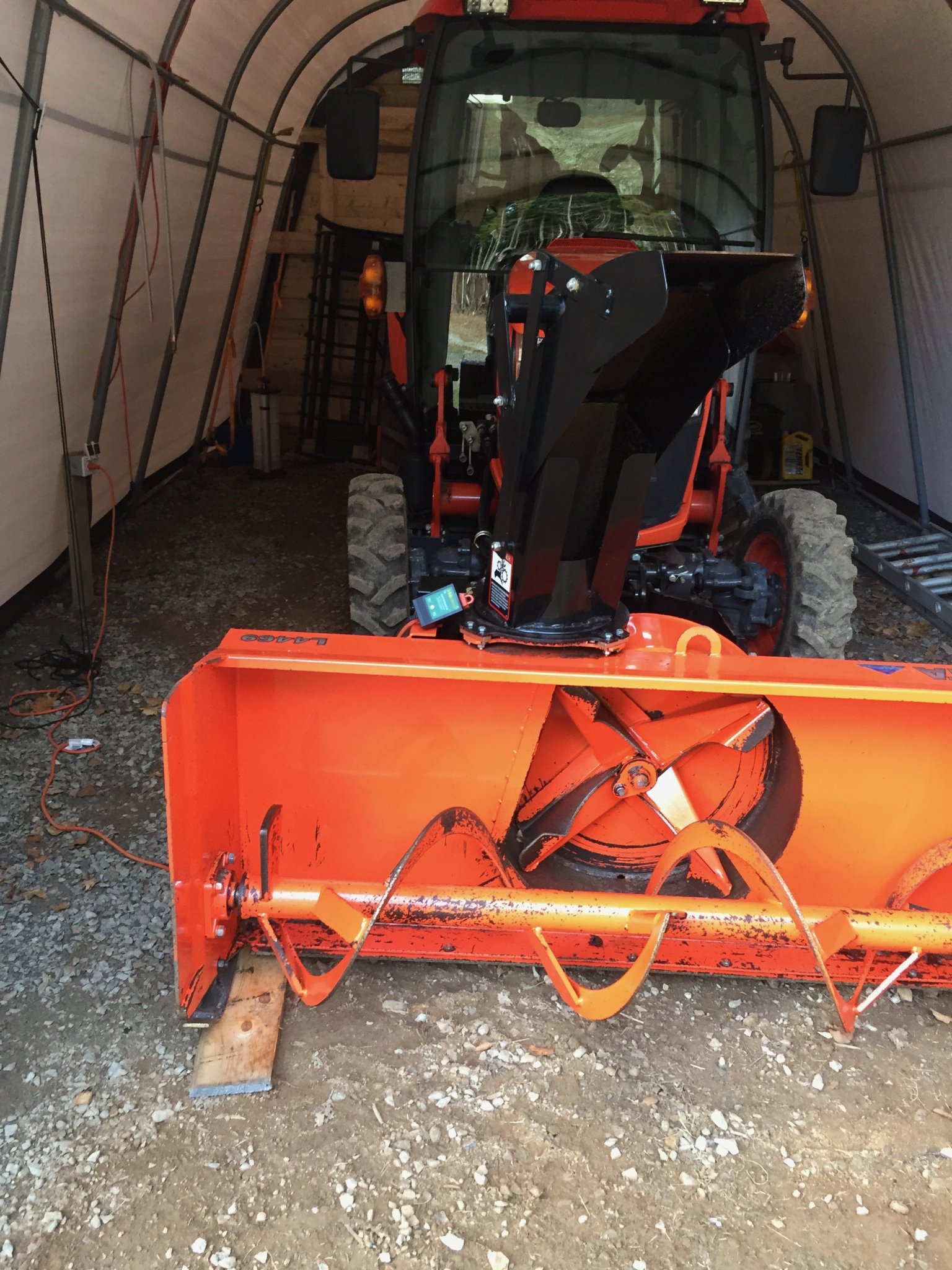

Well I had to put a new cover on my shelter logic after 7 or 8 years this summer and while I was at it I decided to board in the back end with tongue and groove boards because the wind coming down the lake here is brutal at times and shreds the back cover in short order. So far we've had some real good blows and it's holding up real good but the winter noreaster's will soon be upon us so we'll see.

does that hold up well with a good snow load? Looks great!

Thanks Hokie, yes over the last years it has had some real heavy loads on it before I got a chance to clean it off which is some of the reason I had to put a new cover on. This year I picked up a snow rake so I can get at it sooner.

Do I see a widow & vents in that wall?

Looking at that "rack" the chain is hanging on..... is that a land plane ? And next dumb question - this has double doors on the front?

What looks like a window is actually a Shelter logic vent. As it turned out, that alone with one in the front door wasn't enough so I installed a couple floor register vents to help with air flow after boarding it in.

Good eye, yep it's a land plane and a grapple. The door in front is just a roll up door, a bit of a pain in the butt however it does the trick. The biggest thing with these shelters is keeping them in place. I bought rebar that I welded good size nuts to so after I pounded them into the ground I had something to attach ratchet straps to and snugged them down at every second rib...hasn't moved in the whole time it's been there.
