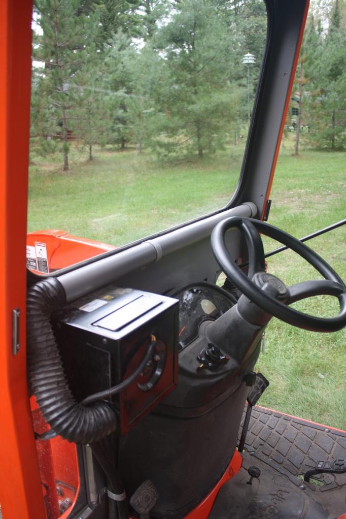

I thought I ought to try blowing snow at night before I have to blow snow at night. So it was time to test the tractor and cab under some night time conditions. Let***8217;s see dark and snowy night, 10 F, 20 mph swirling wind and 4***8221; of fresh snow (12***8221; would be better). Get dressed; worn jeans with hole in knee, snow boots, ball cap, shirt, and light fleece sweater that should do it.
What worked:
Lights - Two 27 watt lcd flood lights provide plenty of light for snow blowing. Brighter lights might be a problem with more light reflected off the swirling snow.
Heater ***8211; Maradyne 503012 piped into the cooling system bypass. I needed the fan on high to stay comfortable tonight. The other day blowing 10***8221; of heavy snow, the engine was loaded up and the heater put out more heat.
Defroster ***8211; The heater came with some hose that I attached to a 2***8221; pvc pipe. The pipe runs across the bottom of the windshield and has four 4***8221; slots cut with the table saw. With the heater blower on, the windshield stays clear and most of the snow quickly melts.
Snowblower deflector - In the woods with the wind swirling around I adjust the tilt of the deflector as often as I rotate it. In the dark you adjust even more to keep the snow plume out of the lights.
What needs improvement:
Back up light ***8211; The small 10 watt back up light is okay for backing up, but I need something brighter for using the rear blade. Will probably upgrade to a single 27 watt flood light.
Head lights ***8211; The head lights reflect off the snowblower and often the snow plume. This wouldn***8217;t be a problem, but at night it would be nice to have instrument lights. Resolved it tonight by turning on the dome light, I plan to unplug the head lamps. The cab mounted flood lights are much better than the head lights anyway.
Cold air leakage ***8211; I didn***8217;t seal up any of the floor or fender openings , and the only cold air I notice is on the back of my legs and seems to come from under the seat. I stuff an extra wool shirt behind the seat that blocks some of the cold air. I may look for a thin rubber mat or sheet to cover the fenders and seat opening, and cut slots for the levers and holes for the seat mount.

Just a couple recommendations on the heat as I have the same heater in my bx.
#1 Use the defrost in the beginning, once your in cab temp is in the 40's; open up the big vent on top, the window won't fog as the air in the cab will be dried by the heat already in the cab. That top vent will turn over enough air to keep the cab toasty with the fan on low.
#2 Block the radiator air intake. Don't just sort of block it, block it up good so you don't get any vacuum.
#3 Sealing the seat area (which is a must as the HST fan pushes air in even if the engine is sealed off) can be done by picking up a 2" thick piece of foam (24" x 24"). Cut the holes for the seat springs and hinge and trim the edges to fit. Once that's done, get the rubber waterproofing spray and paint the whole foam piece. That's what I used and it works great. The foam takes the odd gap shapes all around the seat and the spray seal will prevent air from getting through the foam.
With those three changes I'm confident you will have the heater on low once up to operating temp. I had to move snow at 6am this morning, outside temp was 22 and I did it in nothing but a longsleeve shirt with the blower on low. I've operated it in the low single digits last year also on low once up to temp and I don't have a blower so engine heat isn't as plentiful.

Thanks for the recommendations. #1 & #2 I already had in place. I usually have to keep some heat on the windshield not for fogging as that has not been a problem, but to keep melting the snow. Today I put some carpet under the seat if it doesn't seal well enough I will try your method.
I just noticed your heater is mounted the opposite way from mine. Are you pulling in fresh air from outside or is it recirculating the inside air?
My heater is setup with the intake pointing towards the back of the tractor (blower motor side is up tight against the front of the cab) and it recirculates.
Just recirculating, I thought this way would give me better control of the air flow out of the heater. Probably doesn't matter which way you blow the air out in a small cab.
