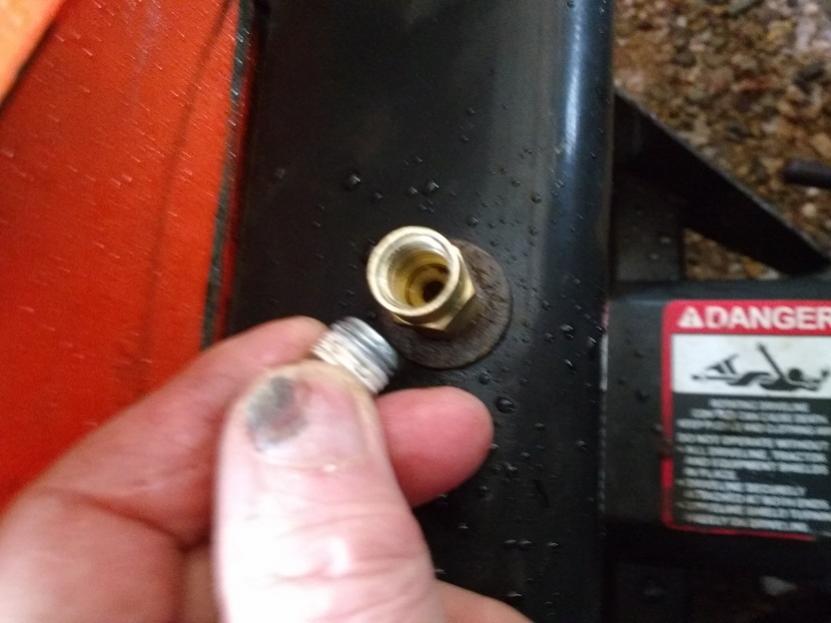

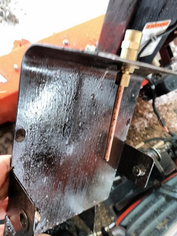

The chain in question had 2 seasons of use and if I recall, probably was not lubed often enough because you need to remove the cover. Not a big deal, but inconvenient in the winter. This mod makes it a lot easier and such, will be used more often.
Simply remove the plug, squirt in some chain oil, and let it trickle down the drop tube, directly onto the chain. The fly in the ointment is that the snowblower should be operating slowly, so the oil is distributed on the chain. My BX has a safety disable switch, which allows the pto to run while the operator is off the seat. Other options to do this may exist, depending on the tractor.
