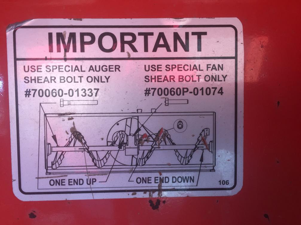

Not sure which blower you have. I have B2771, B2782 and B2550. On the B2771 and B2782 the AUGER takes a special bolt - you'll see it has a circumferential groove machined at both the head end and the thread end of the bolt grip. The IMPELLER takes a standard GRADE 5 bolt. Not grade 7 or 8, grade 5. I've double-checked this (ok, triple checked it) with all three of my local Kubota dealers to make sure I wasn't going to end up screwing up the gearbox. Since they all said the same thing I bought the Kubota-specific bolts for the auger and used my local fastener supply shop to source the Grade 5 bolts for the impeller.
Now for the rest of the story... I've used the B2782 hard this year - not with lots of snow but rather with lots of ice, thanks to recurring freeze/thaw cycles. I've waded into snowbanks that have been pushed up by the township plow, slop from the road that's full of gravel and frozen hard after it was pushed into place by the plow. No, I'm not proud to admit this is the kind of nonsense I've had to work with. I am pleased to say I have yet to break ANY shear bolts in this blower, or any of my Kubota blowers. (Knock on wood...) Get the right bolts in place and I'm pretty sure you will have a similar experience, unless you try to blow through your wood pile. Don't ask... 16" oak cord wood does NOT go through a snowblower!

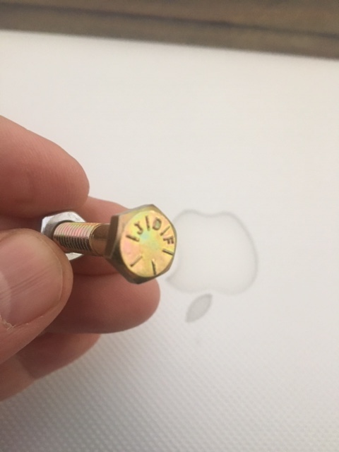

My blower is the B2782B mounted on my B2650 tractor. I have attached a picture of the impeller shear pins provided by the dealer.
Further to ... a few years back I had problems with this same blower and it was determined that the chain was incorrectly installed during the original assembly. The unit had to be taken apart and reassembled by the dealer. Not sure if this may have corrupted the unit internally but clearly something must be wrong with the mechanics if I cannot operate at high throttle speeds without continually breaking the impeller pins.
At this point I may investigate reaming out the impeller pin holes and installing a stronger bolt. I can't imagine this would damage the gearbox if I am only pushing light snow.

I'm wondering about the bolt. The dealer tells me they have provided me with a gold colored #8 bolt (not sure about this) for the impeller and an earlier post recommended #5 only. See pic attached.
I'm also wondering why there is no washer supplied on the gold coloured impeller pins yet the sliver auger pins have both a nut and a washer.

I just re-read your reply. This is interesting. It appears that the dealer has been providing me with Grade 8 pins (gold coloured with 6 markings on the bolt head) for my impeller instead of Grade 5 pins - see pic. That said, I would have thought the grade 8's would be less likely to shear than the grade 5's.

My though is that this bolt should have a lock washer, else vibration will cause the nut to come loose and eventually come off. Have you found any of the sheared bolts in the past? Were they actually sheared, or did they simply fall off?
The grade 8 bolt is a much higher strength than Gr5. Gr 8 has those 6 markings on the head. Don't mess with putting in a larger bolt, you will just break something else....
That all said, the parts manuals for B2782B show a Gr5 bolt for a shear for the fan. Putting in a Gr8 is already stressing something else.... Strange indeed...
EDIT: The parts manual also shows a "locking nut" on that bolt, so no lock washer needed. Be sure you are using a "locknut"
Also, the parts manual shows two different shear bolts, one thru the collar and shaft, the other just a shear bolt on the flange (on latest model). Some models may have different designs...
