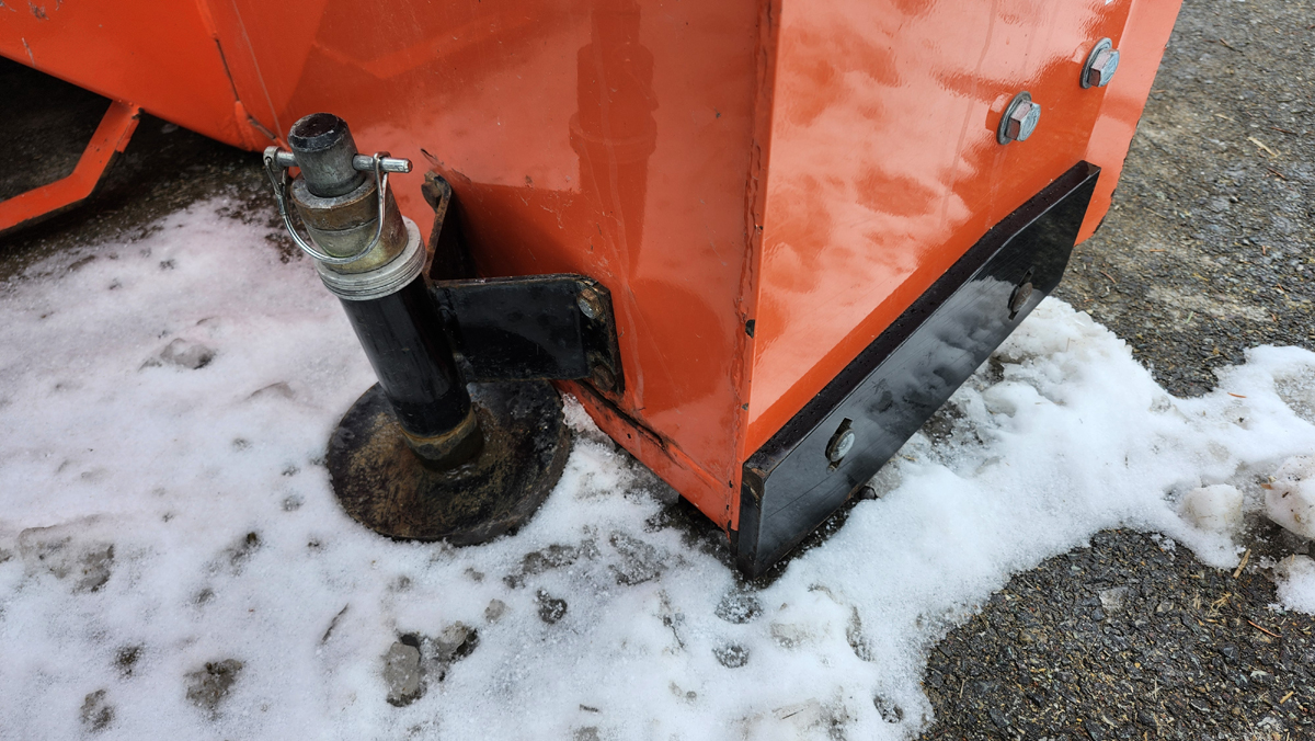

I have found that adjusting the glider feet down a notch or 2 when in softer, less frozen ground conditions at the beginning of the season can help avoid gravel scooping. Then raise the feet back up when the ground has frozen solid.

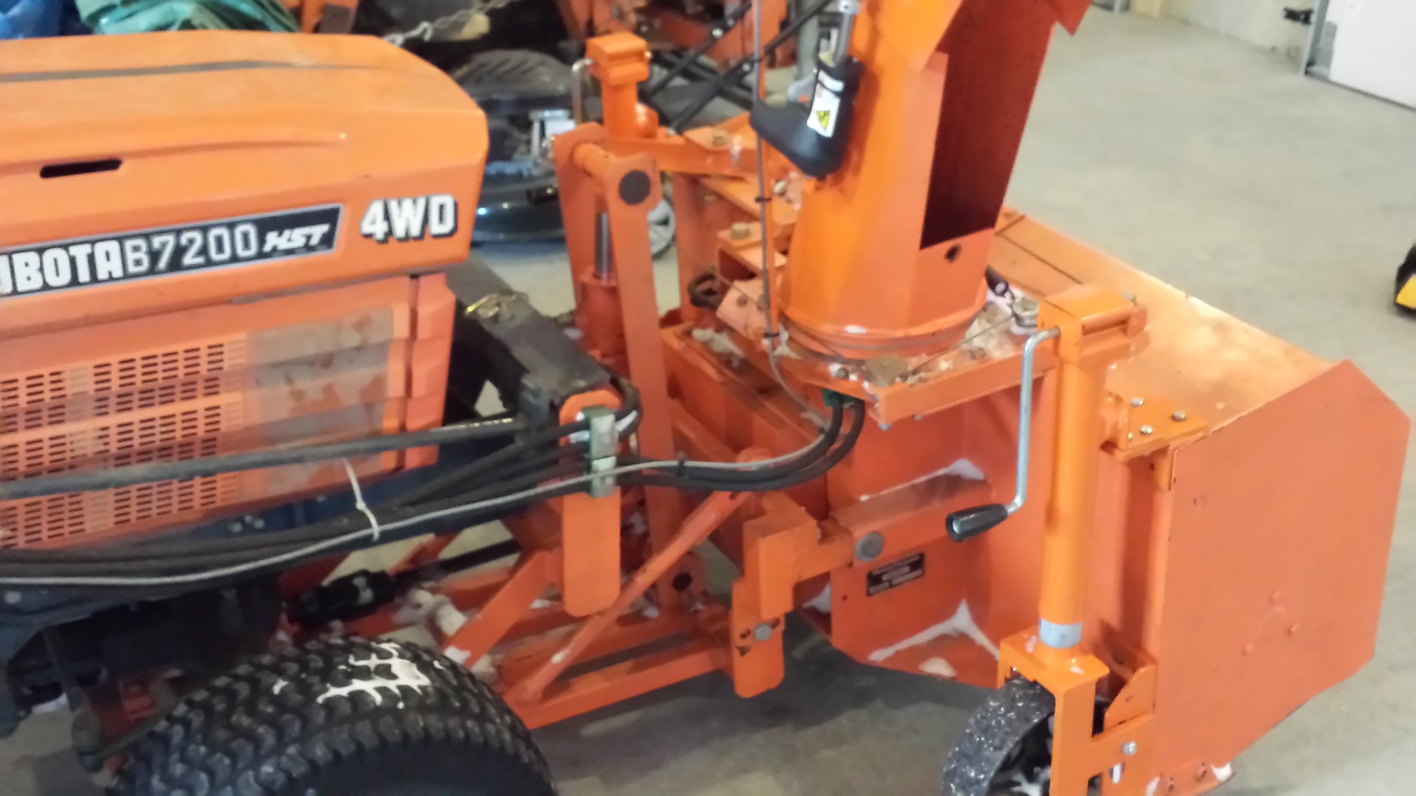

That is the one thing that the factory front mount blower can't do. You cannot adjust the angle at which the blower enters the snow. Years ago, when I retrofitted a blower housing to my old B7200 I made it adjustable as shown in the picture.

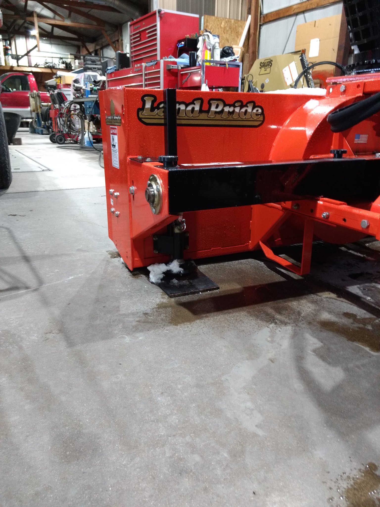

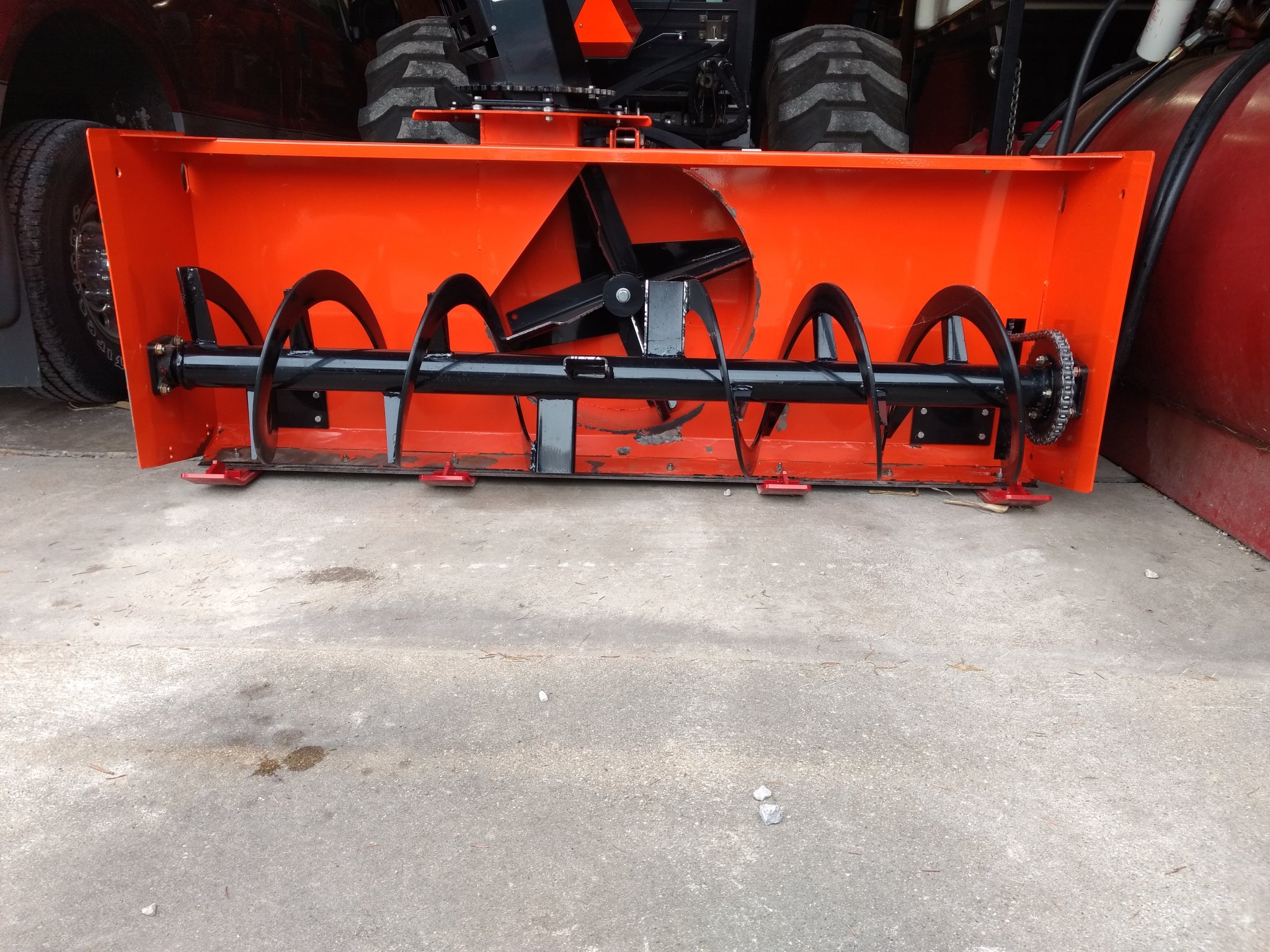

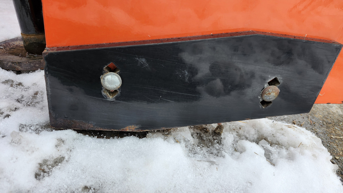

If you look at @mcmxi picture at post #9, and @CAPT Seabee picture at post #13, their shoes are outboard to the housing, which is great. However, the shoes are "slotted" to allow changing cutting height. These are both much larger blowers than my little 4-footer and a better design than mine.
I still don't consider ideal, as the "slots" can allow the shoes to slide up if not paying attention. Not a deal-breaker by any means, just pointing it out.
Just some clarification re my snow blower, the holes in the outboard shoes are discreet and not slotted. There are three sets of square holes for carriage bolts which allow adjustment of elevation and angle. Also, the blower came with the optional rear shoes that are adjustable for height.
I only use the blower on asphalt so I want the cutting edge to be very close to the surface of the driveway which is different to most who blow on gravel surfaces.
