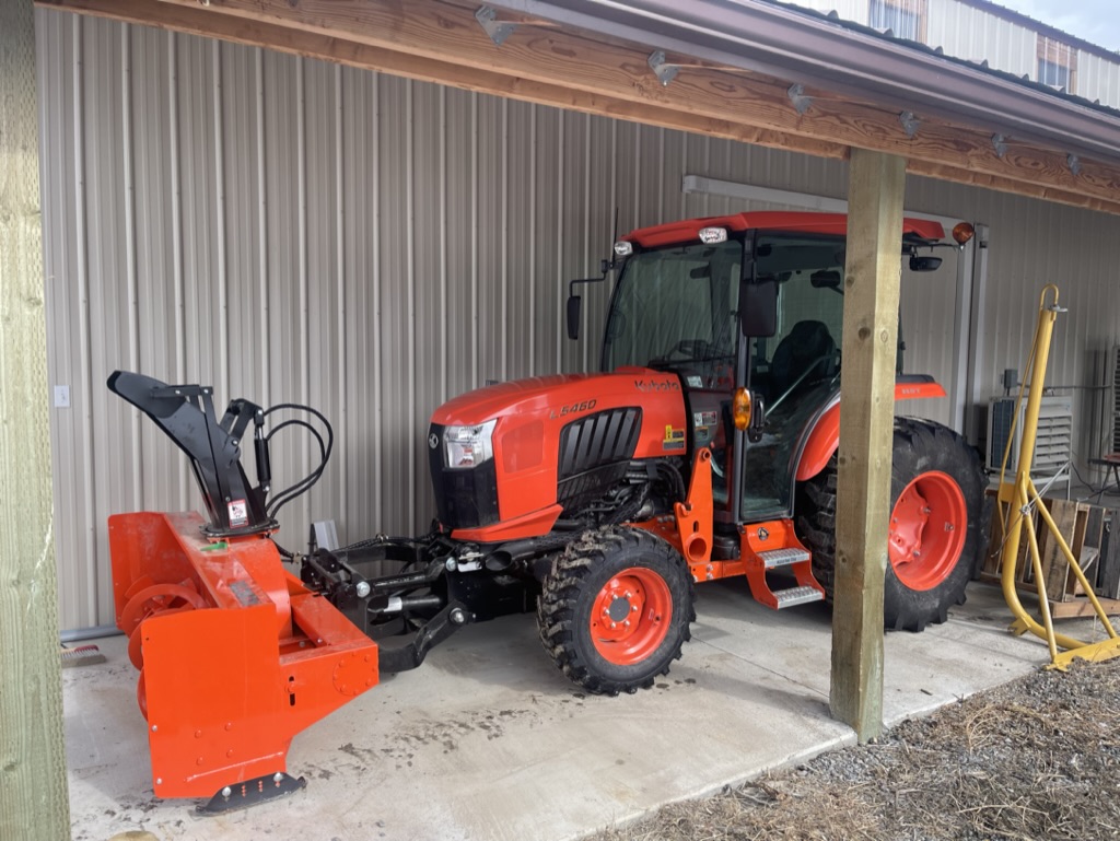

I had a JD 1025R with a blower on front. A few winters ago in -14 degree, I could do about 20 minutes and had to come in to warm up. Repeat and it took longer to warm up. The new set up has be doing in 45 minutes what used to take me 2+ hours. The blower is heavy and the skids need to be much larger. I did see some threads of slitting a pipe and inserting it on the back plate, thus giving more glide over gravel. Make sure you're in float to gain whatever glide you can.

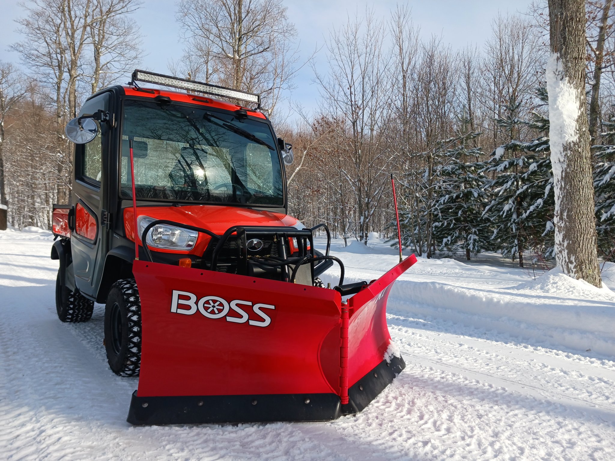

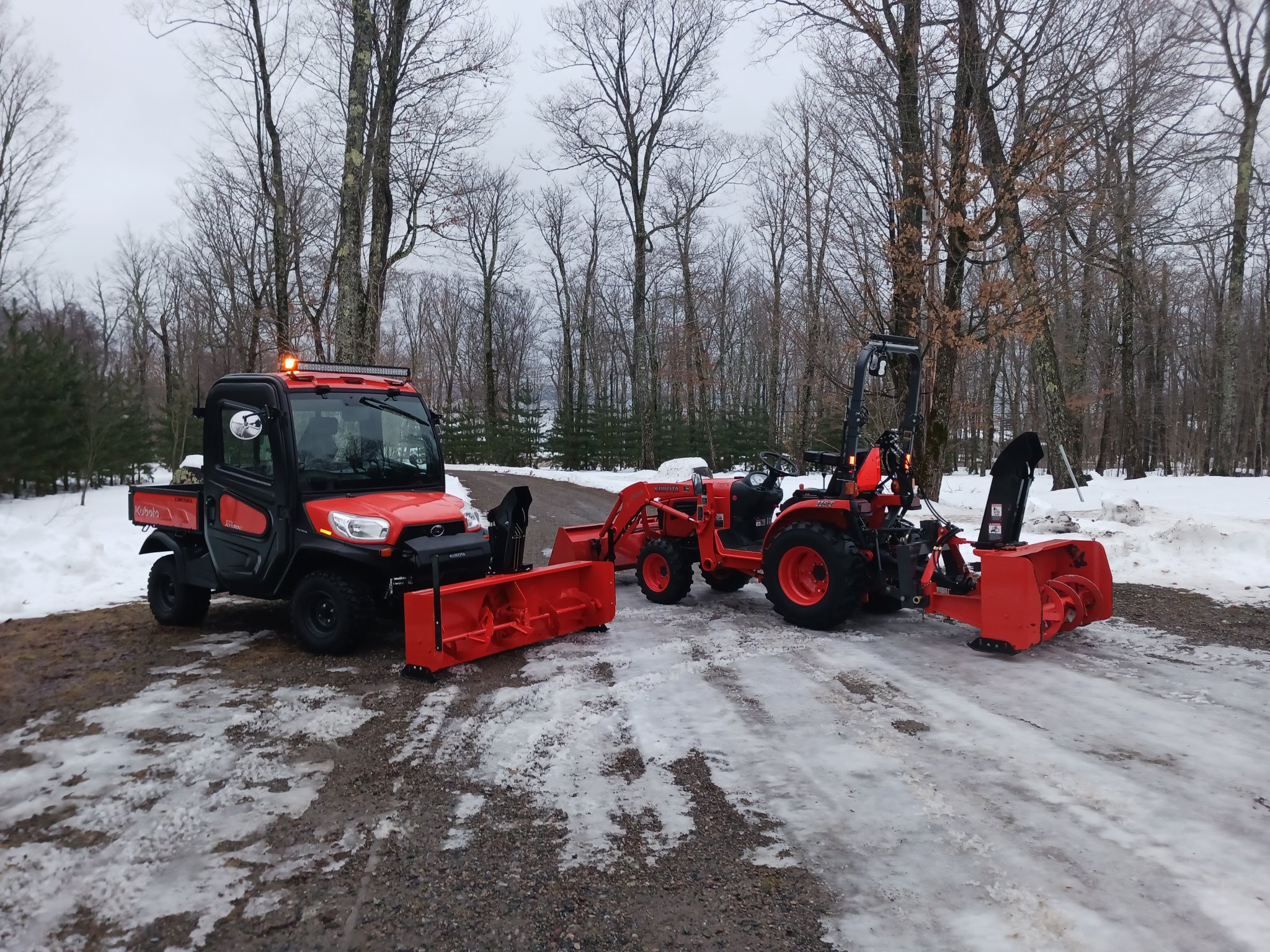

I was in same boat. Always used my B2620 with a rear 3 point blower.
Then, just as you, wanted a warmer option. So bought an RTV-X1100C with a Boss vee plow. It was great, and fast when it was cold and you had a good base. But now that we have been getting lots of thaws and freezing rain cycles between snow dumpings, I just don't like plows. They make a mess. So I took Boss plow off and put a snow blower on the RTV.
Even my wife loves doing the driveway now.
All you need to do is start out with your skid shoes down. It will leave an inch or two on the gravel. Then one you drive on it and pack it and have a base, then you can raise the shoes so it starts cutting. I don't have much problems in my loose 7/8's gravel.
And the reason I love blowers way more than plows is no snowbanks, and you don't have to push the snow.....the blower will eat it's way through it no matter how deep or wet.

Yes, has a frame that goes underneath with a driveshaft. Takes power off engine crankshaft into a drop box that has the electronic clutch in it.
And instead of using the RTV's hydraulics, it has an electric pump and oil reservoir in that front power pack, pretty much same as the Boss plow.

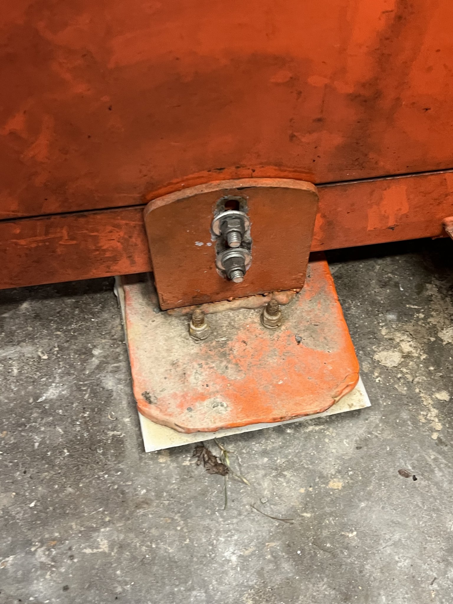

To me, the MOST important thing with a blower on gravel are the shoes.
I really liked the shoes on the JD blower. They were outboard to the housing, and had several bolt-hole options in the blower housing and the shoes for placement.
Various arrangements of the shoes changed the height of the blower's cutting edge to the driveway.
If you look at @mcmxi picture at post #9, and @CAPT Seabee picture at post #13, their shoes are outboard to the housing, which is great. However, the shoes are "slotted" to allow changing cutting height. These are both much larger blowers than my little 4-footer and a better design than mine.
I still don't consider ideal, as the "slots" can allow the shoes to slide up if not paying attention. Not a deal-breaker by any means, just pointing it out.
Early season, I leave about 1.75 inches of snow with the blower to help build up a base. I can then raise the shoes to only leave 0.5" or so once a base is there.
A Counter-Point to the slotted shoes is that they are MUCH easier to adjust cutting height in just a minute or two. Mine are slotted, and it's easy to do. I keep a couple pieces of lumber at 1/2, 1, and 1.5" thick I set the blower cutting edge on to use as "Spacers" to adjust as needed.
The other part related to the shoes is what the gravel/stone driveway is like. It can be a challenge if the gravel/stone is not frozen. Shoes can dig in while running in "float," and stuff starts to get tossed around. You might see the same on occasion with a plow and the shoes dig in.
My BX2750D blower has long since been superseded by "improved" models. Wasn't ever happy with the shoes. They were inboard and would dig in regularly. Poor design IMO. I modified them a couple times to gain surface area on the ground and also lined them with UHMW so they didn't scratch up my patio. They've been great.

As RCW said, skid shoes can and will sink in soft gravel also. When I have that happen, I just put the blower down then lift it slightly instead of leaving in float. That sometimes helps too.
