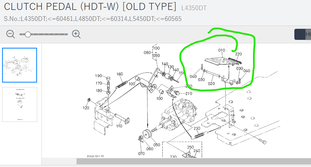

Ok I'm going to eat a little crow on this, it does have an EC but it's not the same as all the rest of the EC's out there.
The normal EC had it in the Bell Housing and was prone to going out.
This model has a dual EC in the transmission.
What they now refer to it as a shuttle clutch.
Now to confirm which exact setup you have.
You'll have to look at the clutch linkage to figure out which one is right:
You should have HDT-W
First clutch lever MDT and HDT look like this.
Clutch lever HDT-W will look like this:
Clutch pedal MDT and HDT
HDT-W clutch pedal

Really if it has the flat clutch pedal that says it all.
J2thesea
1994 Kubota L4350DT LA 950A Loader Woods BH90X Backhoe -1979 Kubota B6100
Feb 12, 2025
Salem, NH
True. I was putting the toddler down as I was looking at those. It has the hydraulic shuttle shift and it definitely has the flat pedal clutch
