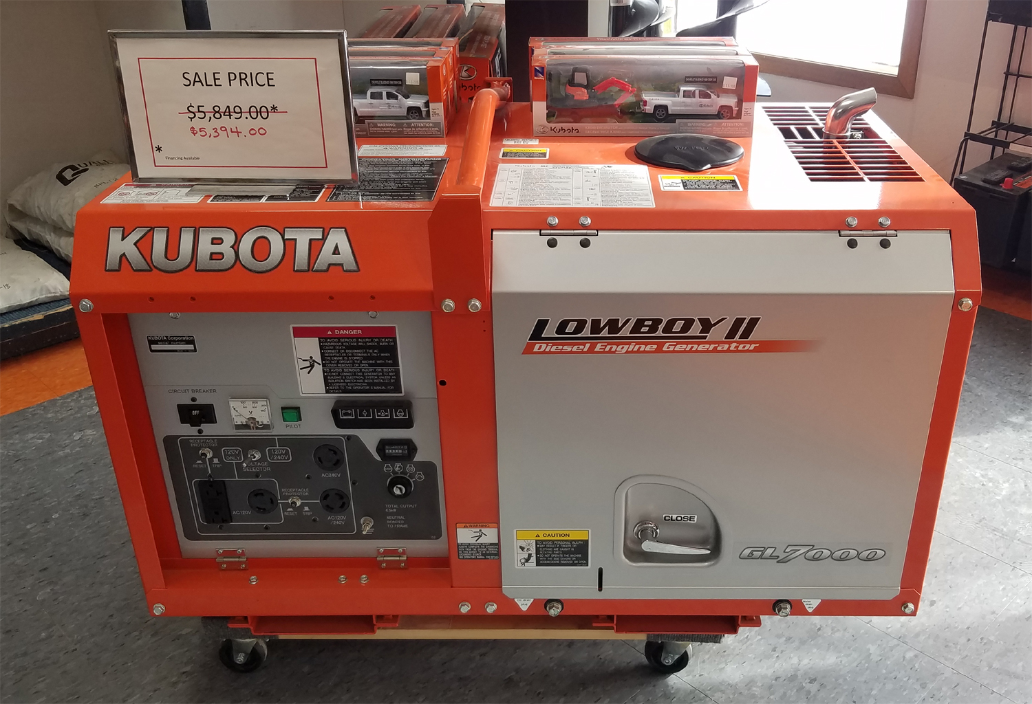

I have the 7kW model but still haven't got around to connecting it to my house via the fancy switch system I bought. I've used it for a couple of extended power outages, and only to run essential stuff. One thing with the Kubota generators is that they run flat out all the time i.e. no governor, and according to the local dealer, you'll get a lot of blow by if they're not working hard.
I need to get into the habit of running mine at least every other month. It sits quietly in the garage waiting for the chance to save the day.
Here it is the day I bought it. Somehow the toy trucks and track hoe didn't make it to my house. :unsure:
