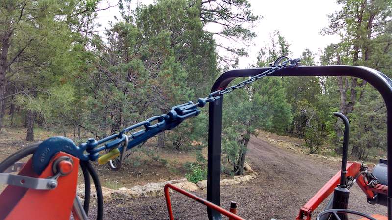

I finally got my B2150 to a point where I could use it a fair bit this last weekend, even though the "dash" is still not together. I really liked the vertical stack that goes up about even with my canopy (on the ROPS). It's on the left side, and I turned the end bend to eject up and to the left.

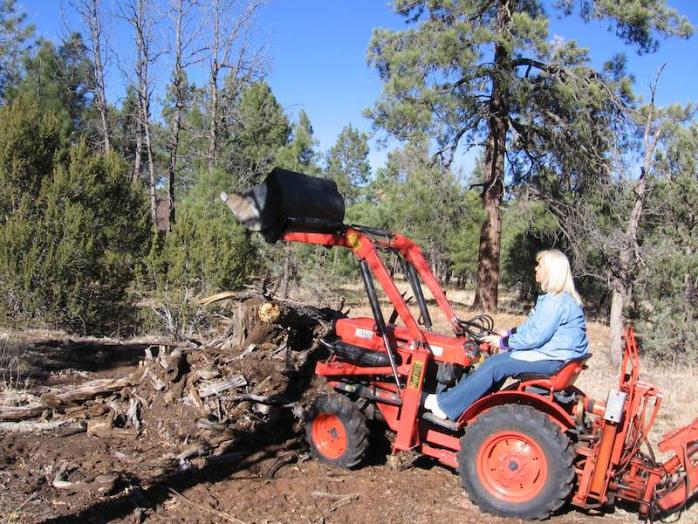

The B7100 that I still have and has seen me through the long down time of the B2150 has the exhaust pointed forward. Sitting mostly still, it doesn't really matter. But most of the time I'm moving forward (or back and forth) at a relatively low rate of speed, and that low exhaust leaves me feeling like I'm choking. I do NOT like it horizontal and forward, but if I went vertical it would need a longer pipe to get it above my head. At that point, being hot gas ejected rapidly upward, it should rise and carry away. Indoor storage and painted garage ceilings not withstanding...
