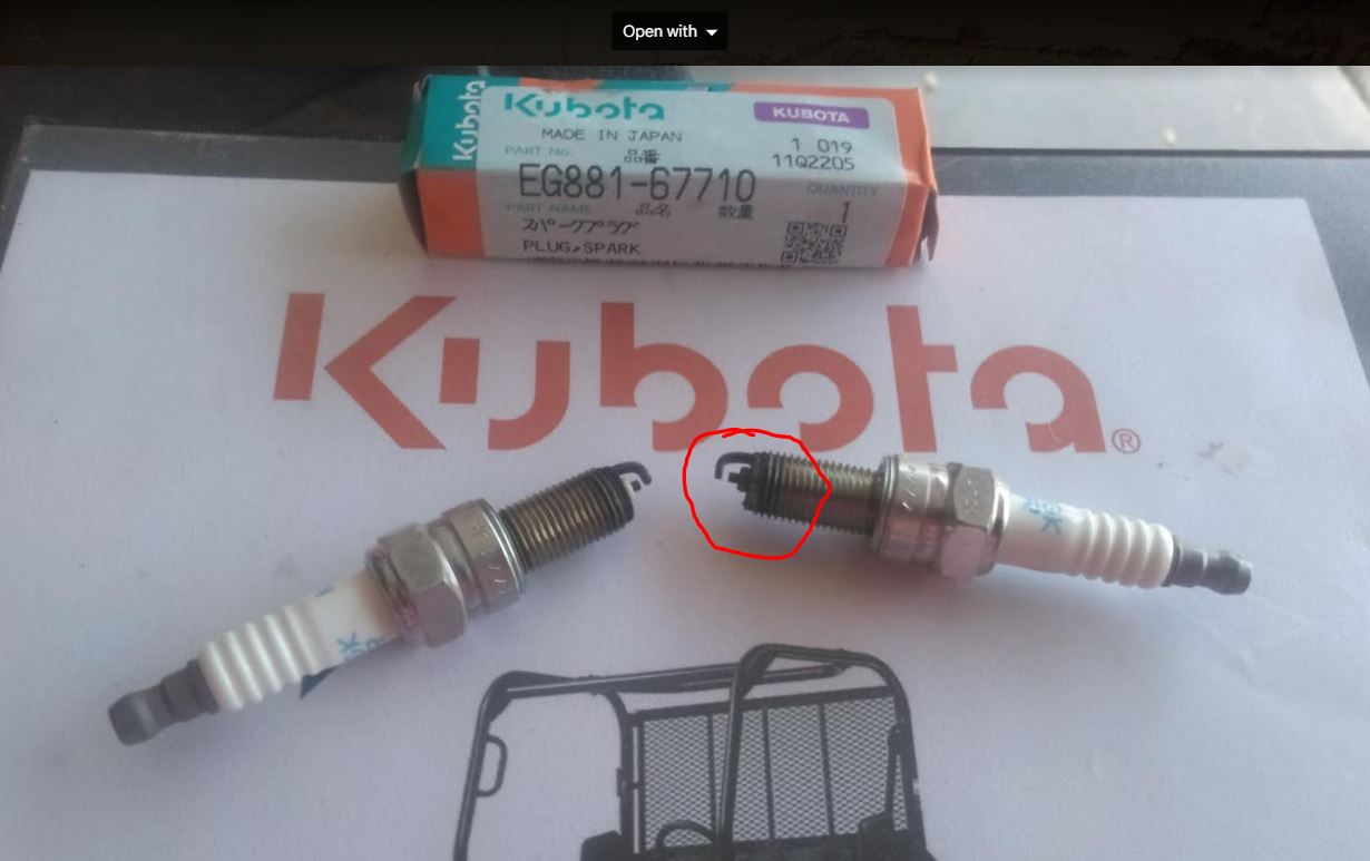

It did end up being the spark plugs that fixed my issue. I did not send it to the mechanic. It runs great now but wow 45 hours and needed new plugs??? As you can see in the picture the one was dirty and had a tar like substance on it. I also filled up the tank with fresh fuel and added a bunch of fuel injector cleaner.
