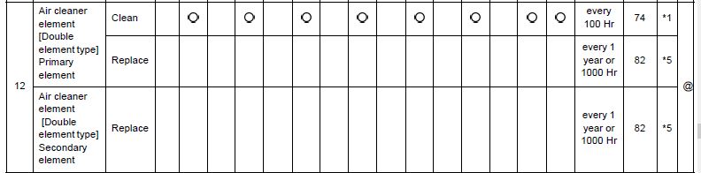

This is from my Operators Manual. If you can wash a fiber filter up to six times, why can't you clean Secondary a stainless steel filter. I would think the stainless steel filter would hold up to cleaning better than a fiber filter.

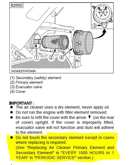

In no manual that I have ever read does it ever say to clean the safety filter under any circumstances.
This manual makes no mention or reference to cleaning it, also says do not touch it unless your replacing it.
