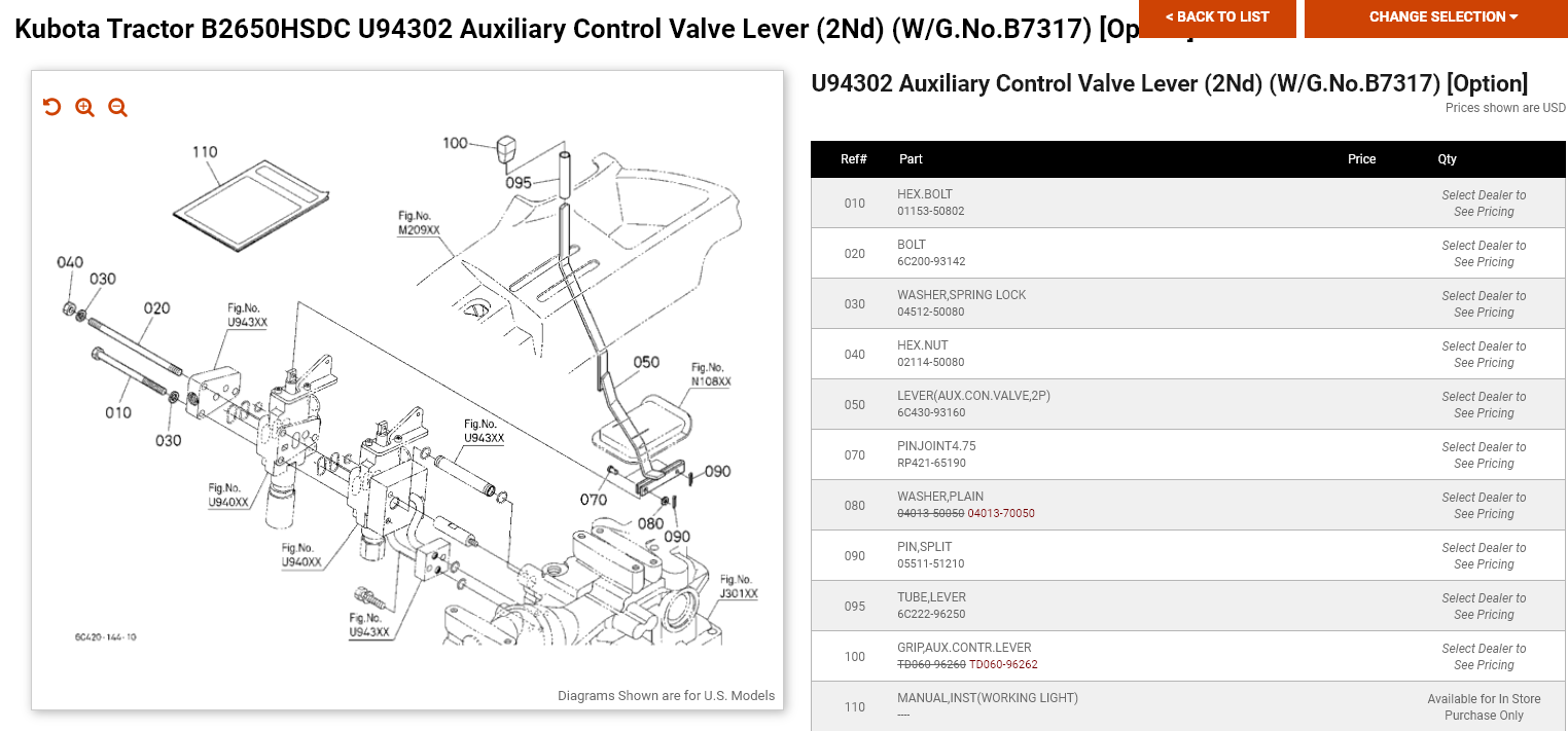

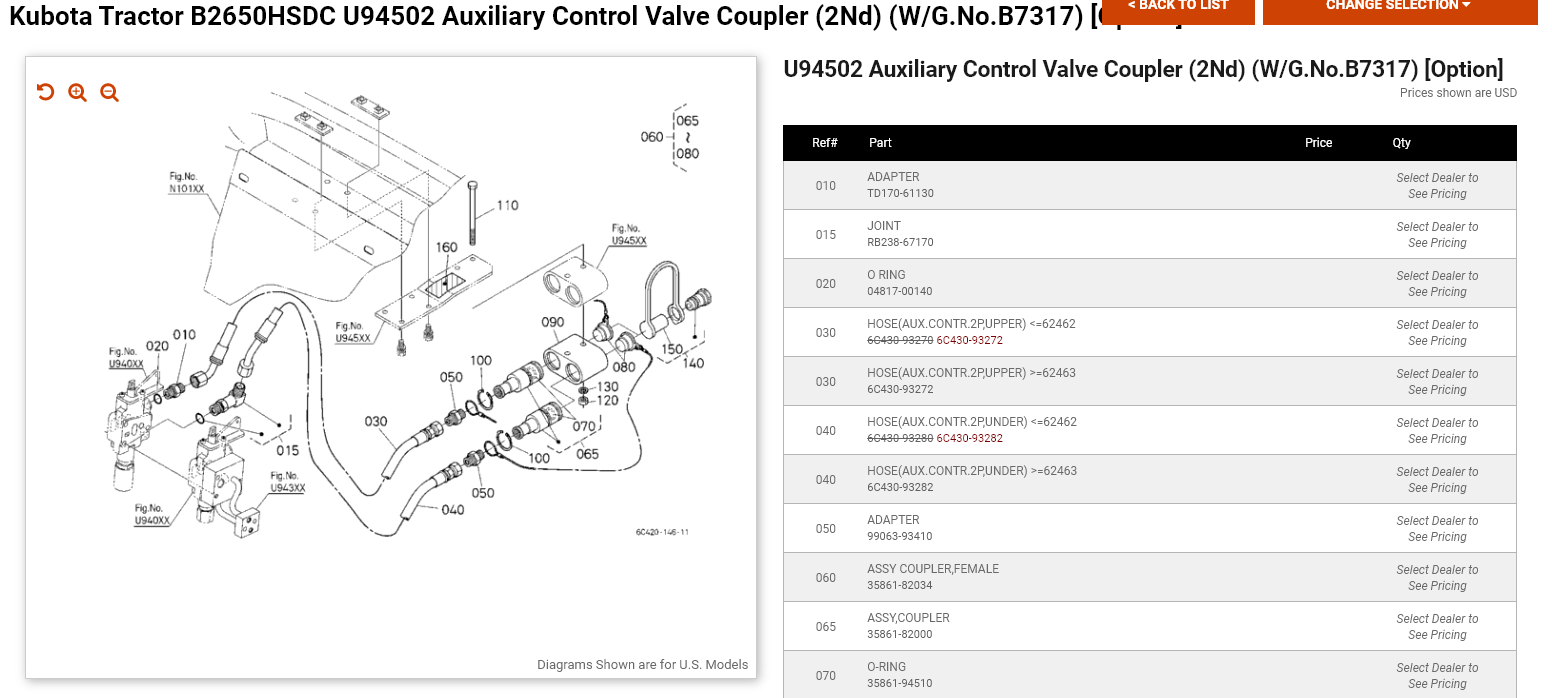

Can you point me to the site you got those lists from? Also, is "U94302" a Kubota kit or part number?
I want to be prepared when I get in touch with the dealer.
7,014
3,394
Thanks, Hokie. Exactly what I needed to know, and I agree - Do it right and do it once. I'll be contacting my Friendly Local Kubota Dealer soon...
Just FYI and convenience the whole goods number for the second remote stacking kit is B7313. Thats everything except the valve itself.
The online parts site is not showing the whole goods numbers for the valves. You will have to choose between 3 position spring center or fourth position float. Messicks spare parts price fpr the valves is $915 and $957. Hopefully the whole goods price is better!!!
Here is alink into the Kubota online parts website. You can navigate the entire parts tree from that starting point
