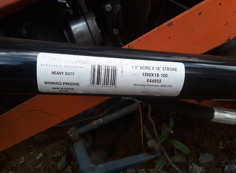

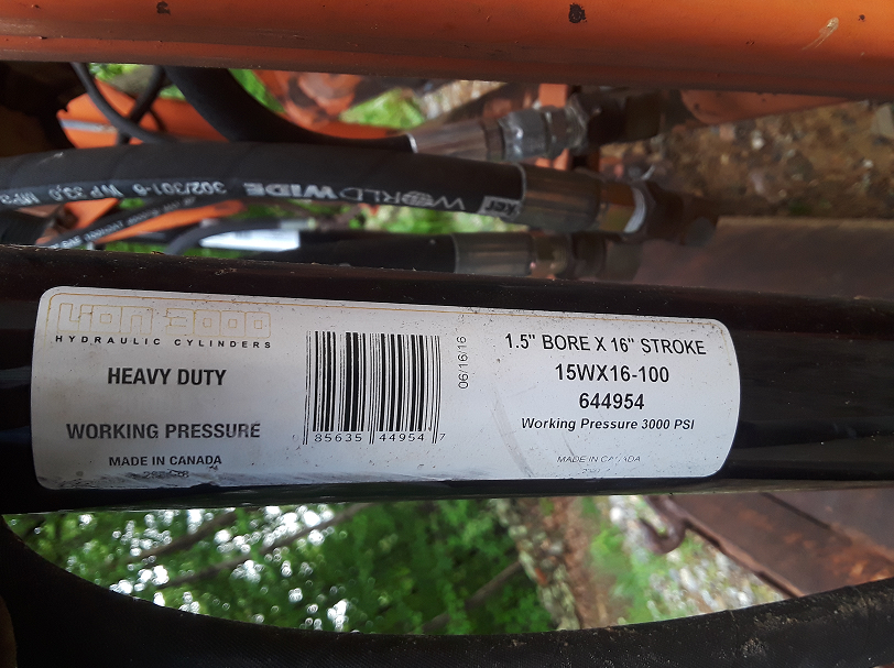

Not as cheap as they were when I got them but brand new and simple drop in replacements. I put the old ones on the shelf for possible rebuild and use in some other project. I also have the OEM seal kits for one if not both the bucket and lift.
Lion Loader Cylinder 15WX16-100 (bucket)
Lion Loader Cylinder 15WX18-100 (lift)
