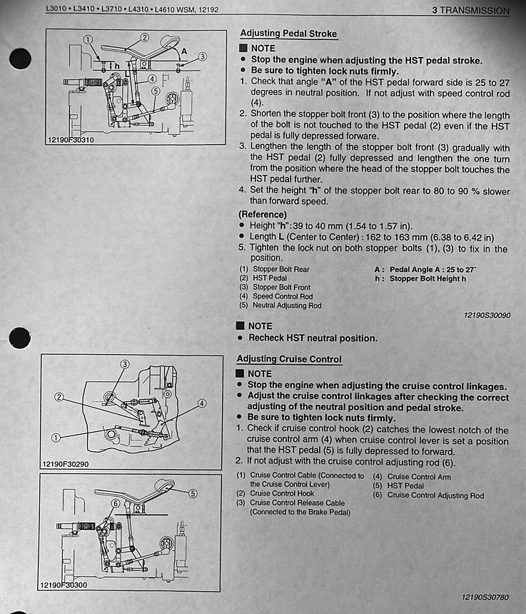

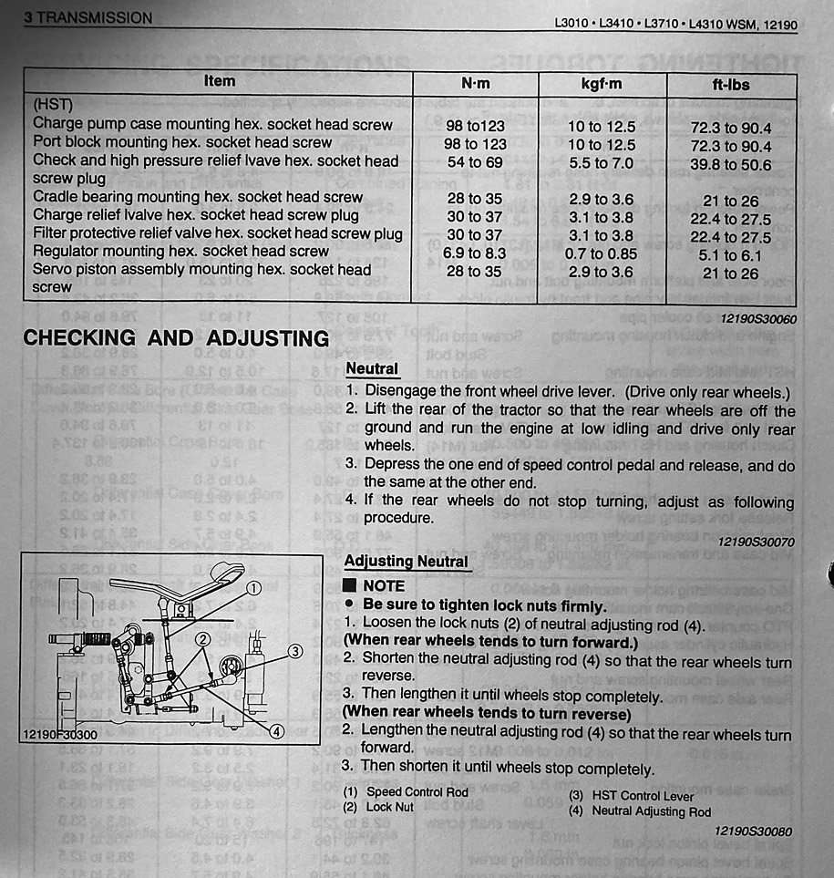

I wonder if I'm supposed to adjust the pedal's rest position.
Attached is an explanation of the linkage and adjustment procedure for your machine taken from the FSM. The only way I could see the pedal affecting the machine during starting is if it was fully depressed and the starter couldn't overcome the load of the system and not turn over. If your NSS is functioning, this would be impossible.
However, there could be other reasons, but you'd need an HST wiz to chime in.....
