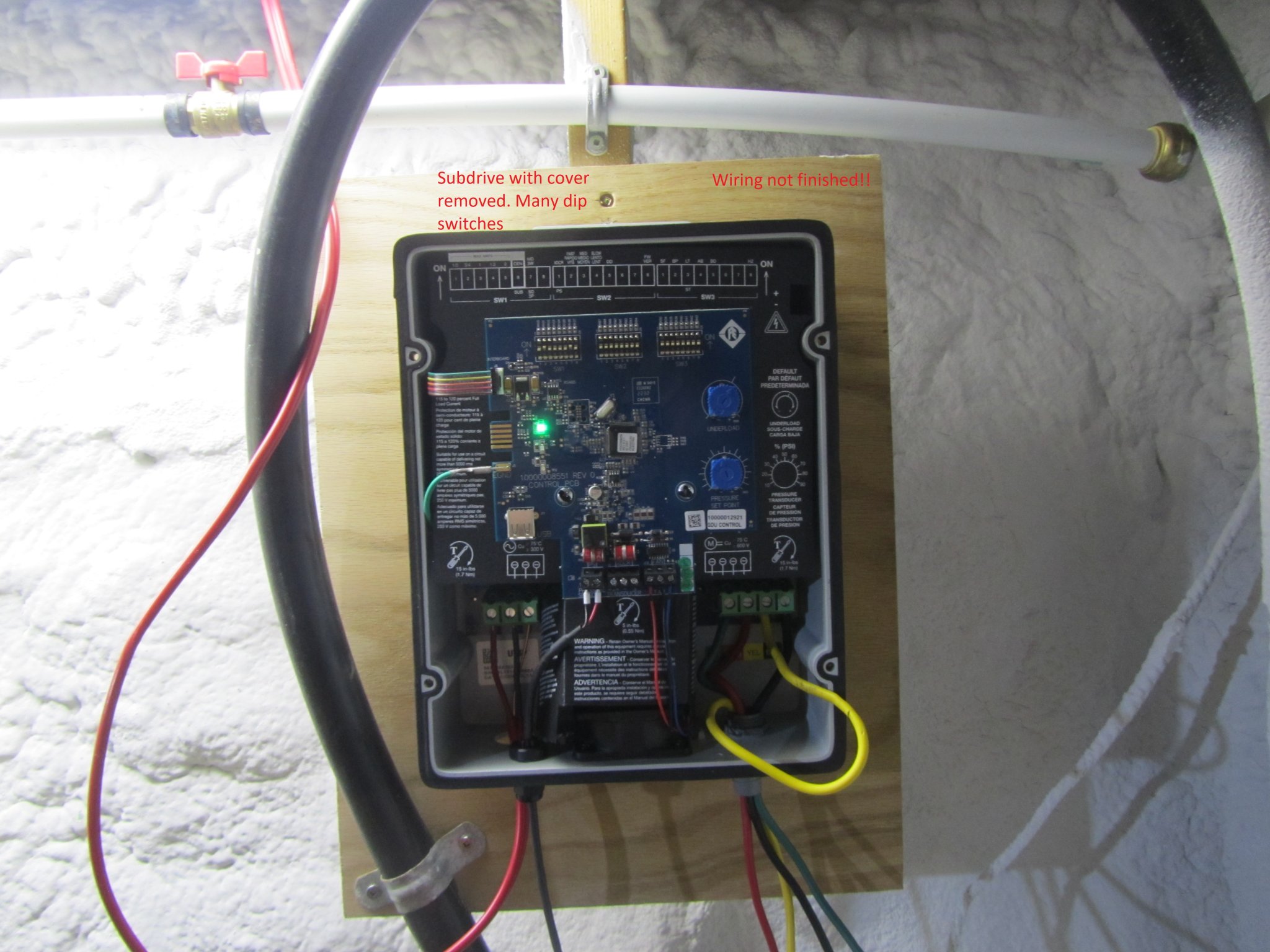

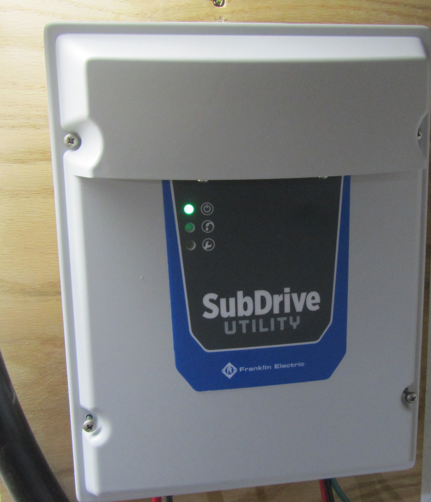

Franklin Electrics new Sub drive utility to the rescue.
You need a 3 wire submersible pump. Red, Yellow, Black and Green as ground.
The sub drive replaces the previous control box with a capacitor and relay. No need to go into the well
The Subdrive turns your existing pump into variable speed pump. In effect your single phase pump becomes a 3 phase variable speed pump.

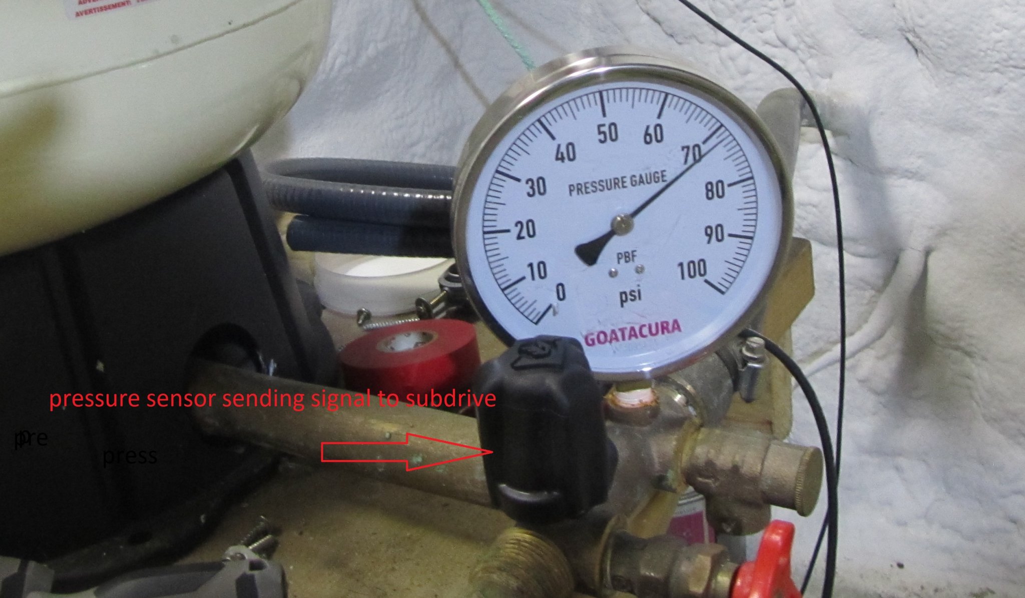

In this configuration the home water pressure remains high and stable. Previously it was on at 40 psi and off at 60 psi.
Now it maintains a steady 72 psi.

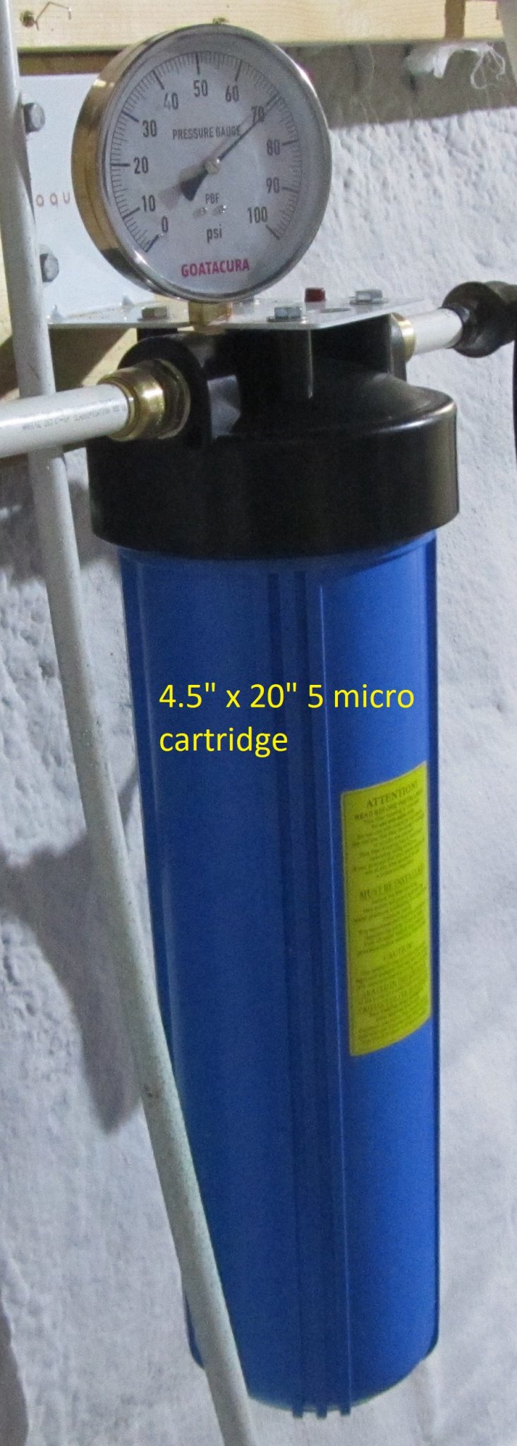

Previously I had a small 5 micron filter before a UV sterilization system but there was so much pressure drop through this filter I replaced it with one 4.5" x 20"
