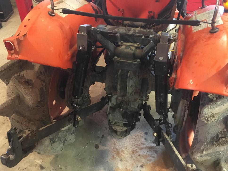

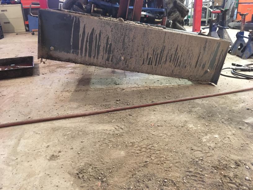

Back to regular programming. IMG_2757.jpg It tilts either way,and if i open valve it pretty much levels itself. Set on level floor and open valve and its level.
Would have been much easier to use conventional hydraulic cylinders as i needed to adapt inverted flare to npt and back to inv flare.
With box scraper all the way up i can stand on either rear corner with no problem.
Need to remember to tighten a couple bolts....and give it a bath,had a couple mishaps with oil...
