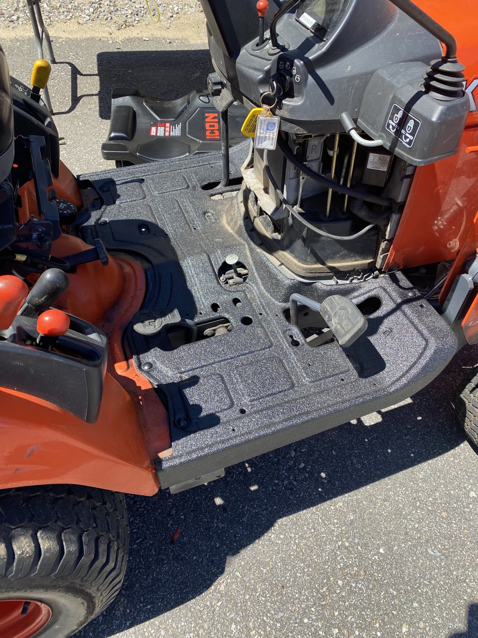

My “step” as they call it rotted out because of the rubber mat not letting water evaporate. I bought a new “step” and had it Linex’d for $80’
This was on a BX25D. Had to re cut a hole as the new step was a bit different.
I remember seeing your original post on that. Was that last year? Or farther back? How's it holding up?
All good! That Line-x is tough stuff. No scratches at all and I’m even using my ice cleats…I did the job in May 2022.
That turned out looking nice!
