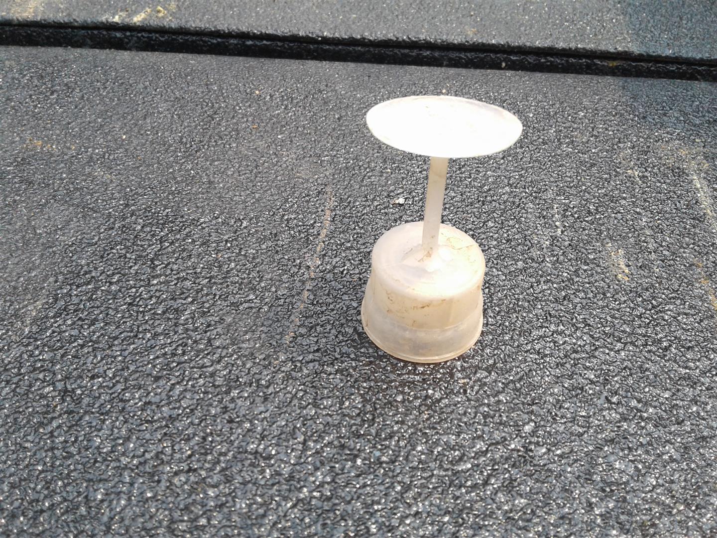

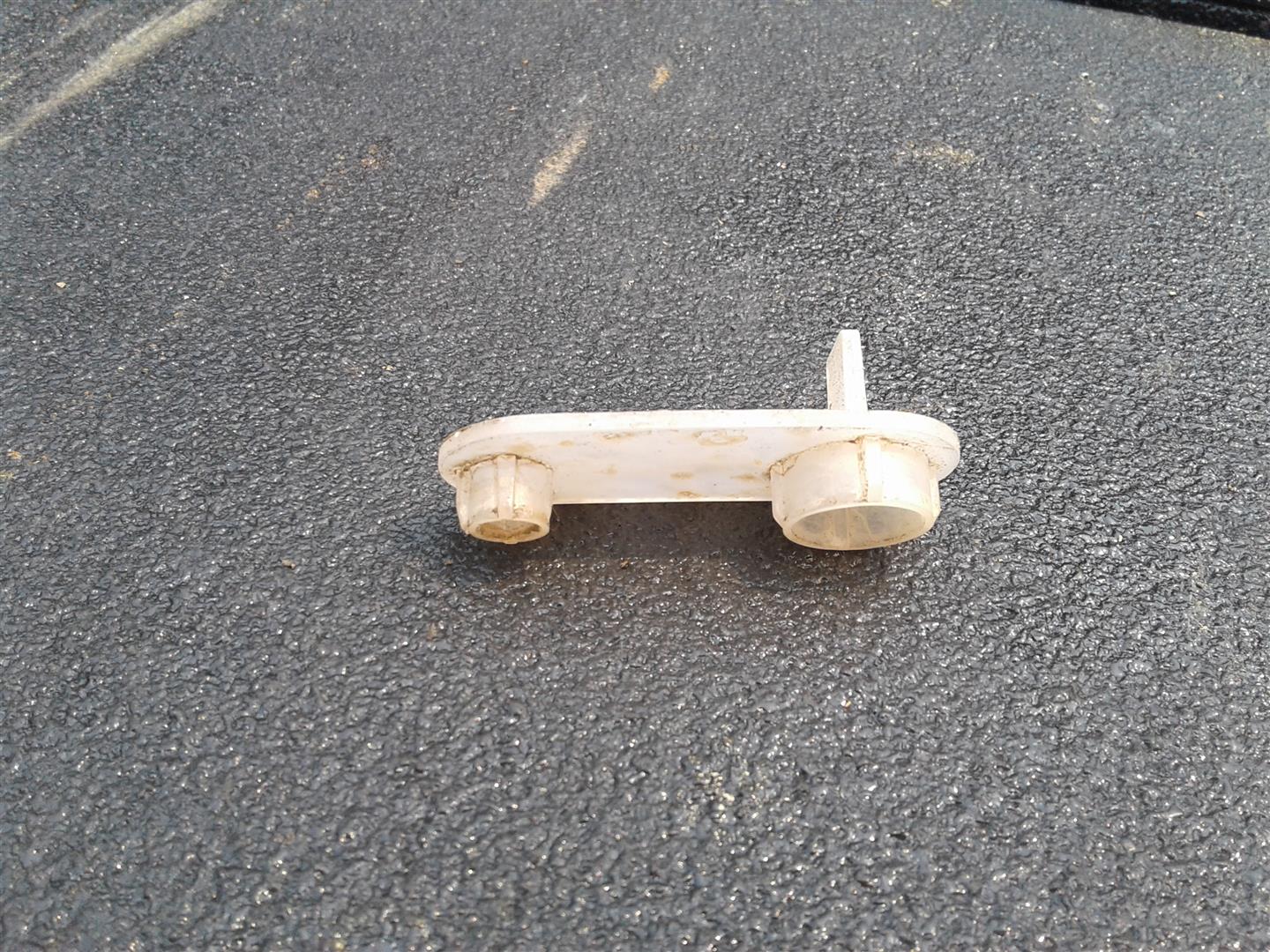

Anybody have any idea what these are? I'm assuming just dummy plugs taken out during assembly? Because I can't find any holes where they would fit.
First one was found in the front belly pan and the single one was found under the front diff in the skid plate.

Yes they are protective caps from components installed during assembly. If I were to venture a guess I would say the top was on the expansion valve and the bottom was on a heater core nipple when hvac housing was installed.

Thanks a lot Fordtech86. It's nice to get a second opinion just in case I overlooked something I wasn't aware of.

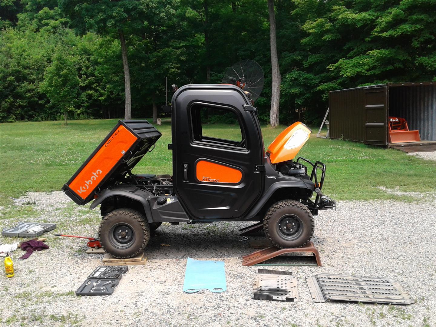

S 20210718_163057 (Large).jpg 20210718_140330 (Large).jpg ervice done. Glad I did it outside, because just when I thought the two HST filters were going to be the easiest part of the job because you can see them right there....I was wrong. I drained the transmission (oil was pretty dark after the first 50 hours) and also had the magnet bolt out (it was pretty dirty too, but no big chunks.) No more oil coming out, so went to pull the filters. And it immediately dumped a LARGE amount of oil out.
And I think the strongest man in Japan put the big suction filter on. Anyway, gotta get some cap wrenches for next time. Not a lot of room to turn my filter wrenches, especially with the rear protection plate on that I added.
Only other surprise was the front knuckle case oil (hubs) was very low. Couldn't see any oil in them. Good PDI there dealer.
And man there is a LOT of rad hose and hose clamps in that thing. Checked all of those too.
Between the Rotella T6 synthetic motor oil and the fresh Kubota Premium UDT it seemed to feel quite a bit peppier. Revs a bit faster now.
And yes, that's a Penzoil gear oil bottle there......but it has Kubota UDT in it. The squeeze bottle is nice for filling the front hubs on this and the tractors.
You do know that the oil in the transmission is not the oil used by the hydrostat which is what the filters are for. The trans/axle housing has no filter for its oil. The filtered oil for the hydro is in the oil tank under the passenger seat which is why you got a lot of oil when you removed the filters.
If you just added oil to the trans/axle (yellow dipstick), you will need to top off your hydraulic tank under the passenger seat.

Holy! Just noticed that. They don't make that very clear in the manual. It reads as though they are separate.
Here it didn't say anything about changing the hydraulic oil so I didn't bother. Now I know, dump every fluid every oil change. Thanks.
