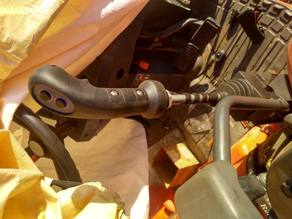

Still waiting on the hoses and JIC 90° fittings. It's very tight in there next to filter. Most people mount on loader upright, this was a harder install. I drilled and tapped into frame. Kubota uses high grade steel; hard to drill and harder to tap.
When I finish I'll throw some pics up. This has been a major maintenance overhaul.
Everything done by the book including the valve adjust. New pins up front. 4 new Titans, front King seal, new seat, fan belt, adjust brakes, adj clutch, new tie rod boot, grease/lube every moving part, etc.
Last it'll get waxed. Will order grapple next month. Space out the bills.
Everything done by the book including the valve adjust. New pins up front, some pins welded and lathed in the rear. 4 new Titans, repaired swing cylinder leak, new fulcrums on backhoe levers, new cable on loader control, front King seal, new seat, fan belt, adjust brakes, adj clutch, new tie rods, grease/lube every moving part, etc.
Now I gotta learn how to use it.
FYI: The fittings that are in your picture are not JIC fittings, they are pipe thread fittings. ;)
So if your trying to match those up JIC's are not going to work.
I used those fittings for fitment. It's tight and wanted to make sure of clearance. I'm using #8 male JIC x #8 ORB 90° which are closer than what's on there now. Should be plenty of room for female JIC straight swivels with 1/2" hose.
