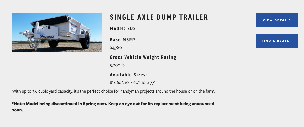

Another option is to simply have one custom built. Find a local fabshop,basic 4by8 SAdumper, maybe $2K, south of the 49th.
That DiamondC unit has a GVWR of 5000 yet NO actual trailer weight or 'payload' rating !! 3.6cubic yards of stone weighs a LOT more than 3.6 cubic yards of foam peanuts .....

You probably can't pull this one with your tractor but I sure liked the quality of their build and I was looking at one I can pull with my Toyota Tacoma.
https://www.diamondc.com/trailers/dump/
My Load Trail 5'x8' 5000# gvw single axle dumper has 18" depth box. That's a standard basic depth, but Diamond c sells height extenders. So that's 5x8x1.5 ft = 60 cu. ft. volume. 60 / 27 cu ft per yard = 2.2 cu yds. Not 3.6, not without taller sides.
