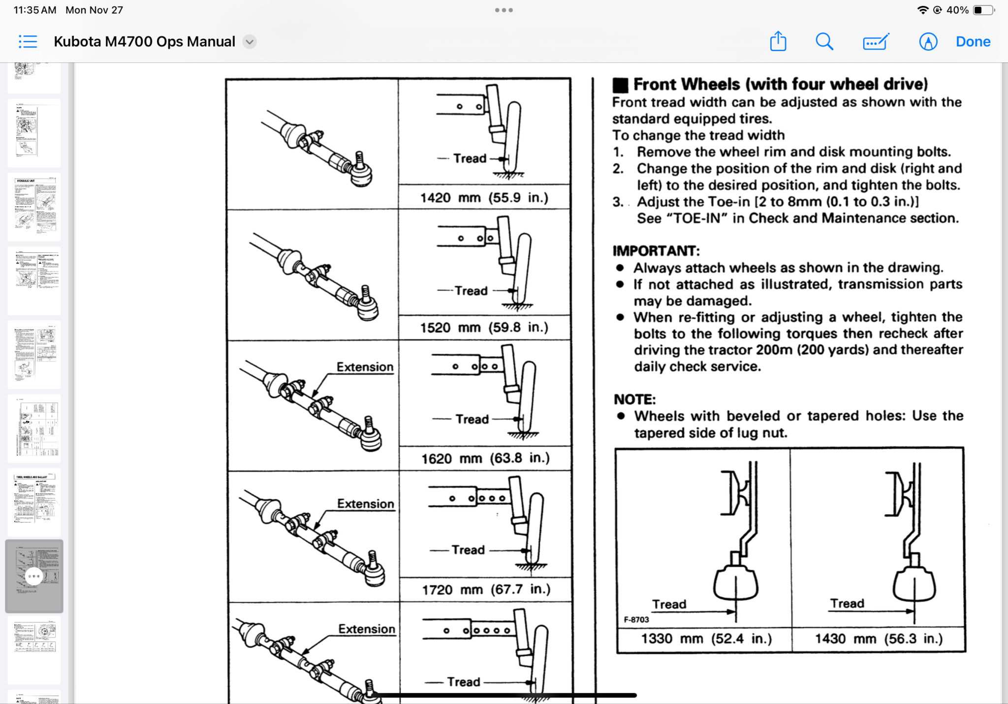

My Owners Manual allows the front wheel rim to be placed inside or outside the disc…but neither prohibits OR discusses reversing the disc…(which I suppose means reversing the disc is not approved.):
It's in the verbiage to NOT reverese the rims!
