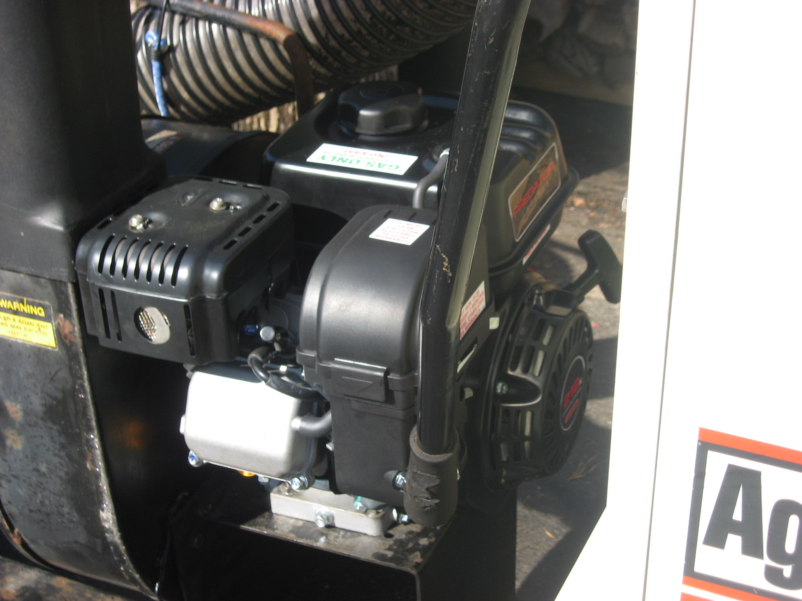

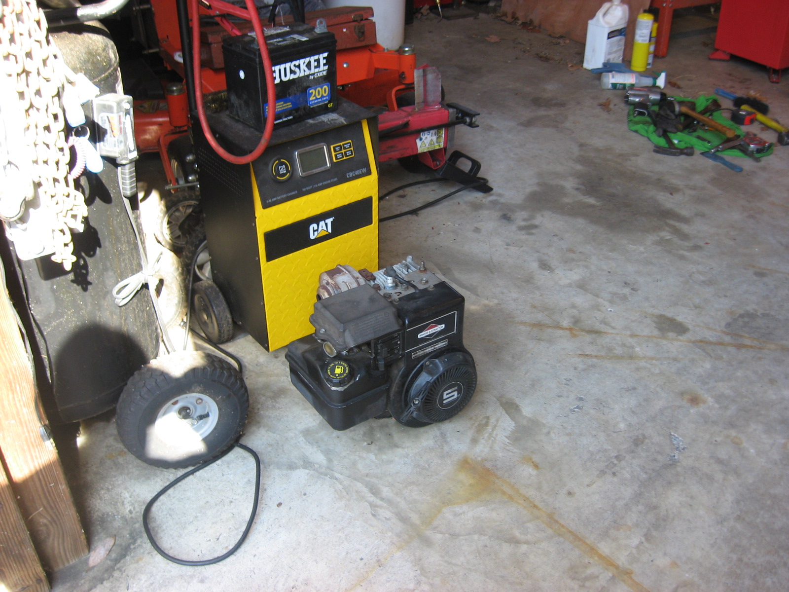

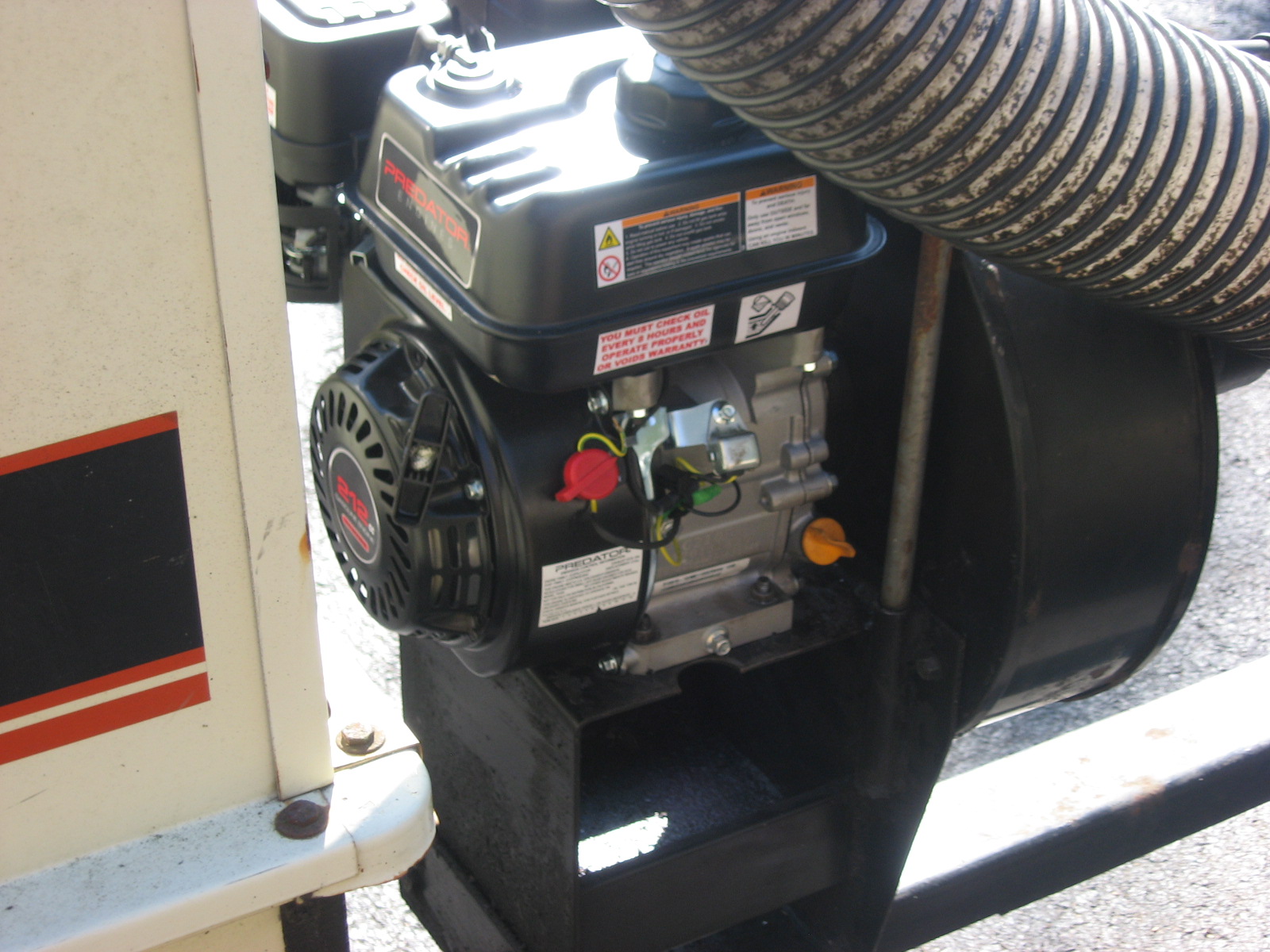

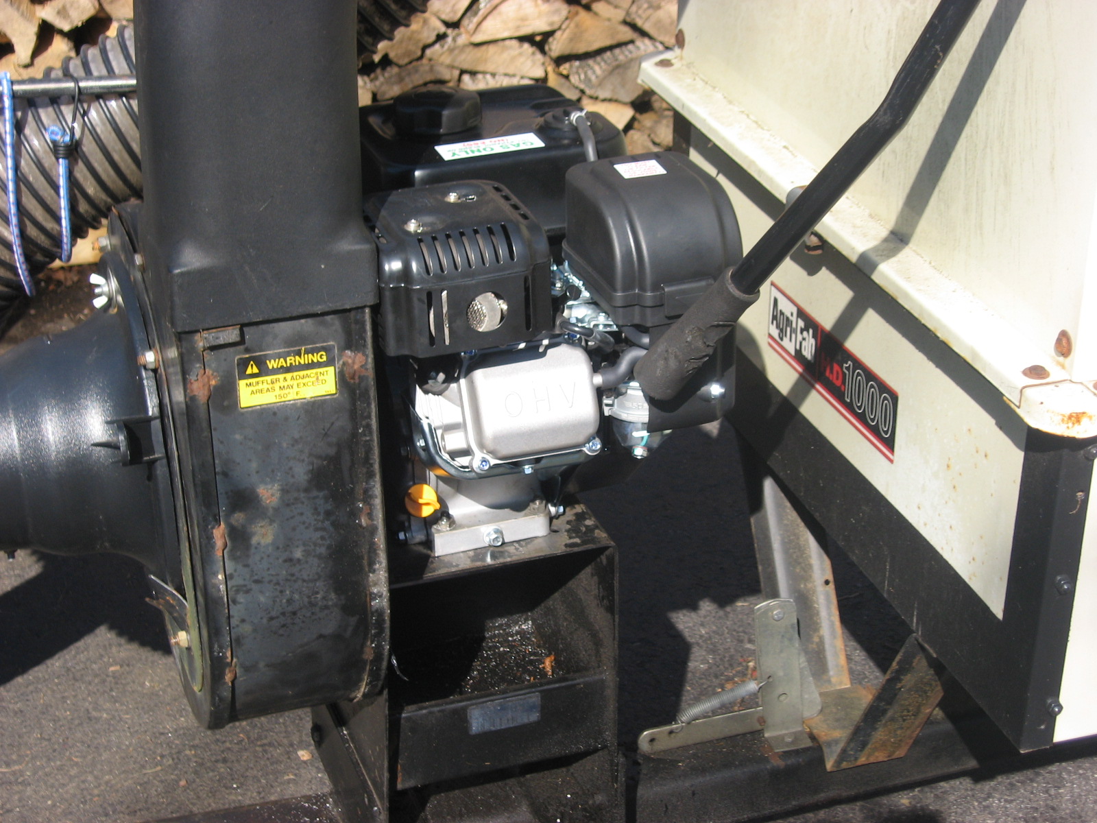

About 5-6 years ago I purchased an Agri Fab Mow N Vac, It is an older one where the shaft of the motor and impeller vane faces to the front not to the side like the new ones do, Well it has an old 5HP Briggs & Stratton Motor on it and I knew I would eventually have to replace the motor as it has been leaking oil really bad, Last spring I purchased one of Harbor Freights 212 CC Predator motors, they are OHV and are basically a clone of the Honda 6.5Hp motor, My research shows that these motors are dependable and very economical, I paid $109.00 + NJ tax, I know it's Chinese but a new 6.5HP motor for that price, I had to have it, Well I spent the better part of the last 2 days trying to get the impeller van off the old Briggs 5HP, I purchased the crazy tool that screws into the vane and is supposed to push it off but the threads on it stripped, I had used heat and penetrating oil and they still stripped, So back to square 1, blocks of wood, a straight pry bar and a 5lb lump hammer, eventually it came off, I knew when I bought it that it had a 3/4" shaft and the old Briggs had a 1" shaft so I purchased the shaft adapter which I had to shorten because it was a little too long, Well...to make a long story short I have that new 6.5HP OHV on and it purrs like a kitten, The OHV motor has a higher RPM range produces more suction.
Photos...Yes Even a pic of the old tired B&S 5hp I replaced which I will now rebuild:)

very nice repower !
That 'predator' engine looks same as the 'power fist' or 'pro point' ones Princess Auto sell here in Canada. I've had 100% success with them even replacing Honda 9HP units on motar mixers.
