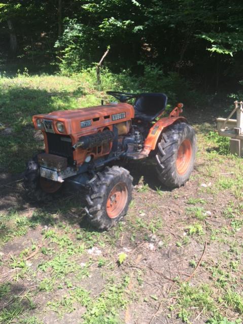

I ordered fronts by Carlisle from Simpletire, arrived in two days $135 delivered, another $20 to have them installed and my lag in the front went away in 4wd
