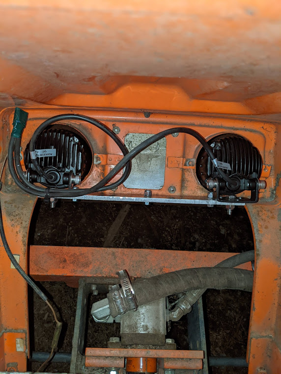

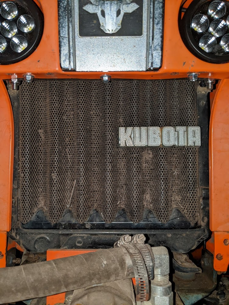

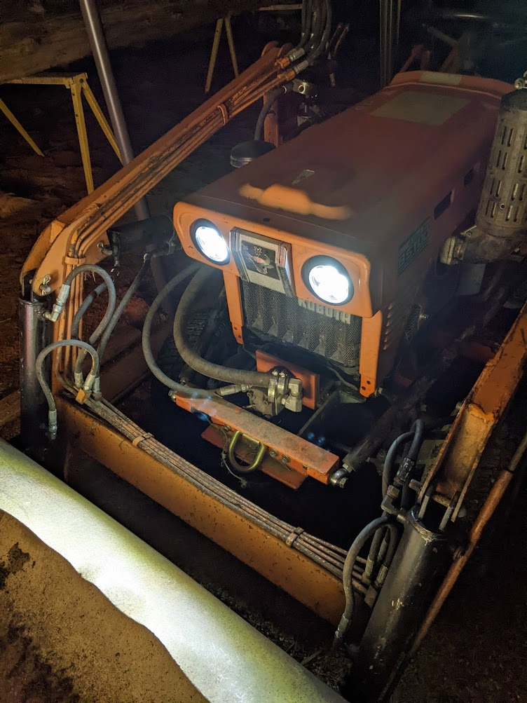

The headlights on my B5100 were broken/not working when I got the tractor a few years back. I finally replaced them with 3.5" LED work lights from Amazon, mounted on a piece of 1/4" aluminum 1.5" x 11.75", which I fastened to the hood just about the radiator (see second photo).. These lights are really bright and pull the same current ( 18W) than the stock incandescent glow beams, but put out betwen 5 and 10 times as much light. They're enclosed in a solid waterproof (IP69) aluminum casing w/ stainless heardware, and the pair costs less than replacing one of the OEM originals. They're not road legal, but I don't run the tractor at night on the road.
There's just enough space around the lights (3/16" or so) to be able to adjust the aim, but w/ floods it's not really necessary. Now I need to design a grill guard to protect the lights and that doesn't get in the way of the hoses and when I open the hood. I had to straighten the sheet metal a bit as the headlight area had clearly taken a hit.
I still need to add some hazard flashers, a tail light and some reflectors to operate on the road legally in WA; a rear work light on the rops wouldn't hurt either.
- Bart
The center 3 bolts hold the aluminum plate against the the top orange flange of the hood; the outside
bolts are the mounting studs of the lights. Clearances are a bit tight in the this tractor. All self-locking hardware.

Hi Barts, thanks for your post. Can you add a photo of the inside the hood view? I am considering the same idea.

Hi Dave -
I checked the wiring diagram when I replaced the regulator last year. The lights clearly work on DC - and they work w/ the tractor off (and the switch on, of course), so they're running on DC from the battery.
Sure...
Here's a view w/ the hood tipped down, so you can see the loader pump. The lights are bolted to a 11.75" long x 1.5" wide piece of 1/4" aluminum plate, which is in turn bolted to the edge of the radiator hood opening. I was concerned it might be too flexible, but it's nice and stiff - no need for a brace.
I used the original wiring light switch; you can see the brown wire there. I'll add some adhesive zip tie clips when I pick up my wiring suppplies from CA soon. In the mean time, this works.
