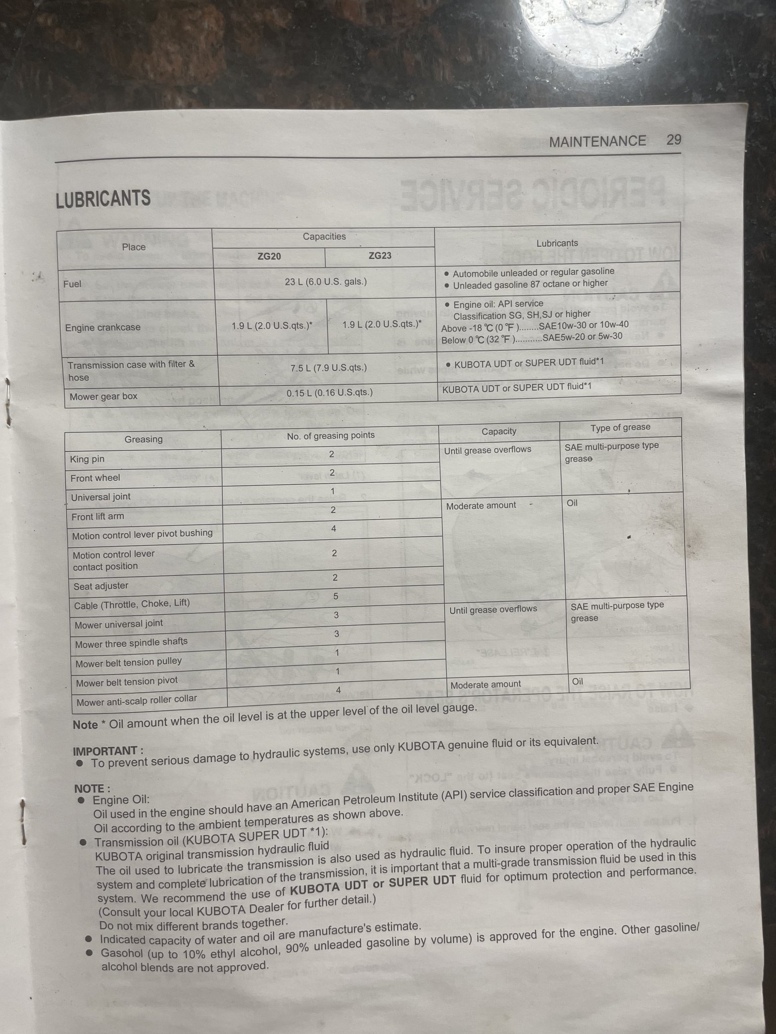

The manual calls for 80W-90 gear lube, NOT UDT in the gearbox.

Mine's a RCK54-23BX. Maybe there's a difference in gearboxes.

so I called my local Kubota shop and they told me the gearboxes come from the factory with super udt oil but they use 80-90w when they service them so that makes more sense. I will use 80-90w oil.
