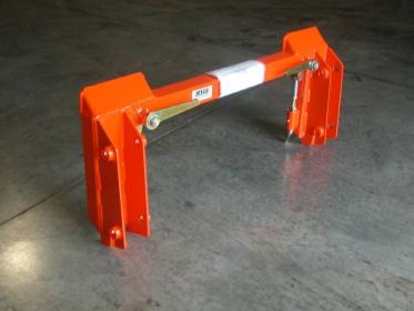

I pieced together information from this forum and a few other forums, as well as online information in order to figure out what would work for me. My goal is to save all of you the time in case you're interested in converting your machine to a SSQA.
The L2230A is a Kubota official quick attach that conforms with the ISO standard and will fit all bobcat style attachments. This unit has a 1" diameter pin size.
The following loaders from Kubota also use 1" pins. LA401, LA402, LA452, LA480, LA481, LA482, LA680, LA681, LA682, LB402, LB552 & LB702
Additionally BF500, BF550, LA450, LA500, & LA650 do as well.
The width and distance between the "ears" on the bucket vary slightly from model to model but I can confirm that the BF350, LA402 and LA682 all will accept the L2230A coupler. It will pin on without modification and perform normally. I personally have put the coupler on these machines.
Coupler measurements:
93.8mm (37 7/8") to the INSIDE of the ears.
110mm (43 1/4") to the OUTSIDE of the ears.
9.5" center to center on the pins. Pins are 1" dia.
You will note that there is a little excess play since the L2230A is WIDER than the loaders....as a result you can order up 94639A898 or similar from McMaster and cut those to fit. They're nylon spacers that will keep the bucket from moving side to side.
I paid around $450 from my Kubota dealer and you should be able to negotiate the same.
EDIT: You will need to talk to the SALES department, not PARTS to get this adapter. They won't be able to find this with the parts lookup, but sales team can look it up easily. Since sales has freedom to mark things up or down, try to influence them to give you a "good deal".

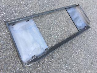

Of course you will need to order the quick attach plates if you're going to re-use your bucket.

Yes the L2230 is the right SSQA adapter for the LA463.
I don't know why any dealer couldn't find it it's right on Kubota's parts site?Now if you can actually find and buy the L2230 might be another option.

I bought an L2230A a few weeks ago for my L4200. I don***8217;t know if the A makes a difference. It fits mine, but I had to add some spacers on the pins since the inside dimensions were different. Outside to outside was perfect. I used 1***8221; washers to fill the space. An adapter from EA was $887, but this 2230A was only $469. I was very happy to get it. The dealer had it in stock, because he had ordered it wrong for another tractor. It was quite easy to put on, once I had removed the original bucket. 4 one inch pins.

Yes, according to at least one poster, the stops are too far back and will allow the cylinder to contact the arm when all the way curled. On my la680 it lined up just right.

I purchased the L2230a from Coleman Equipment for my LA463 OE Kubota part was around $540 shipping $250 but still well below the aftermarket and 25 lb heavier built

I ordered a Kubota L2230A quick attach for my LA463 from Coleman equipment for around $700 the ATI was about $1100
