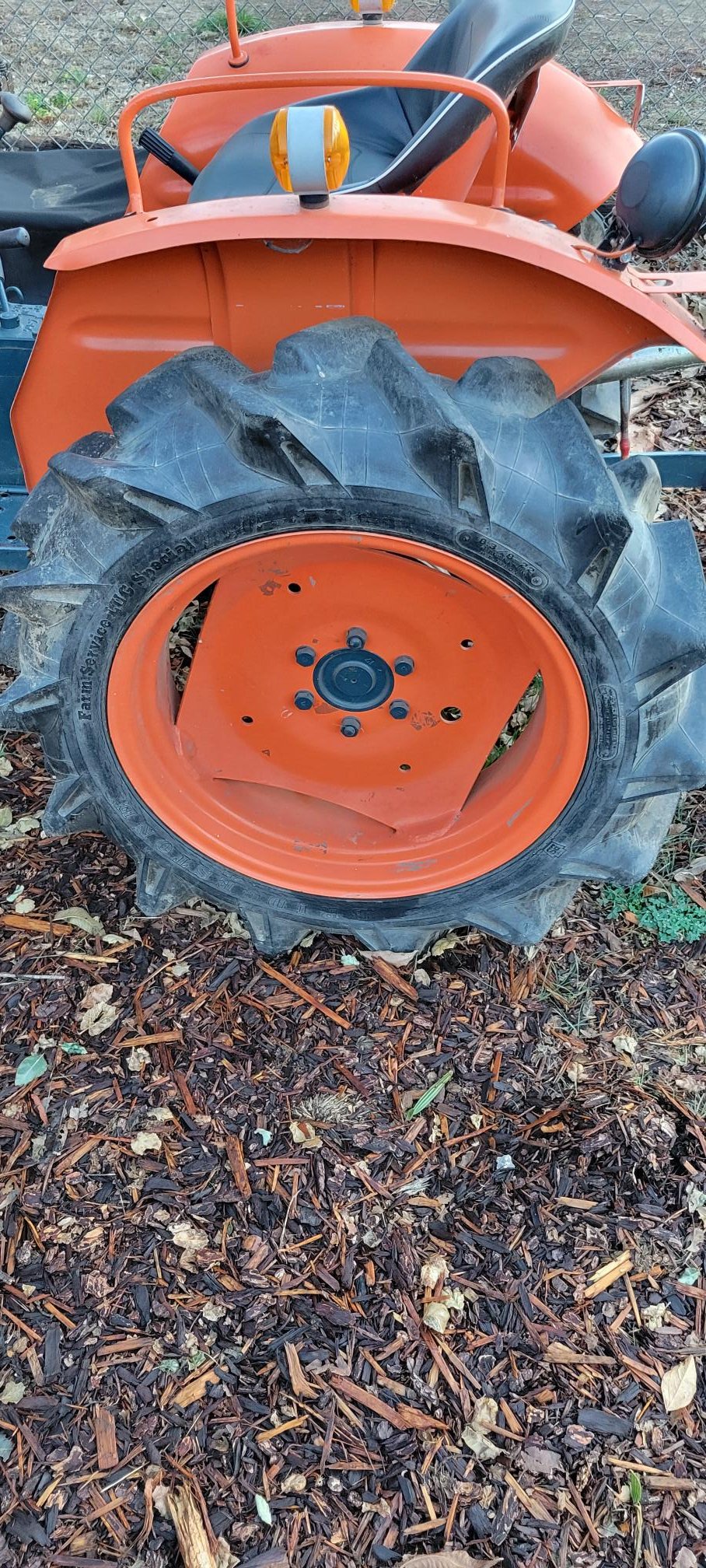

The existing tires are 8.3/8-22 size. I will try to attach a picture.
Any help you can offer finding this size would be great or let me know where to find new rims if that is what I need to do. The tractor has 4wd capability but I have never used it on my property, never seemed to need it.

Google shows several, looks like they're all R2. Do you have a farm tire dealer nearby?
