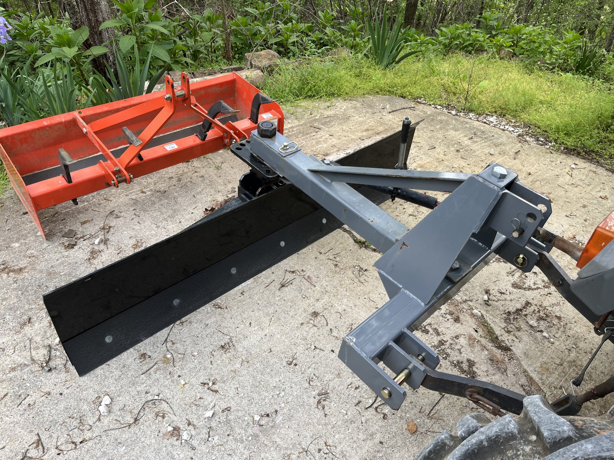

772# is less than the lift capacity... I have ballast, about 1000 pounds, 55 gallon drum for grapple work... I think you'll be able to use the blade BUT only heading down hill!!! Which is what I do with my 6 foot Tufline blade.... For ditching, the blade follows my tire track. Not ideal but doable (and sometimes scary!!)

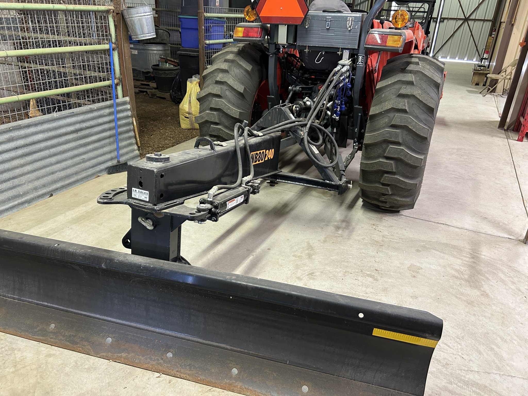

My tear scraper blade weighs 1025# and it’s very useful for cutting ditches when tilted and offset. Rear blades are very useful IF they are heavy. Lightweight blades are near useless because they just skip over the ground. In fact I prefer them over box blades because they are more versatile.
According to the literature, the NB80-240 is 850lb for the manual model and 913lb for the three-way hydraulic model. The NB120-240 manual model is 1,025lb. Looks like you have the NB80-240.
The Buhler/Farm-King I bought last year is an 8096 (Series 80) and weighs 970lb in the manual version and around 1,050lb with the three-way hydraulics. I only run it on the M6060 at present, and most likely wouldn't run it on the MX6000. It's a bit of a beast.
Mine is three way hydraulic, not manual. But you are correct that I read the wrong weight. It’s 950# in the hydraulic mode. I don’t have the tilt cylinder on the blade because I have the hydraulic tilt on the 3ph. It is a bit of a beast, but the MX6000 handles it well.
