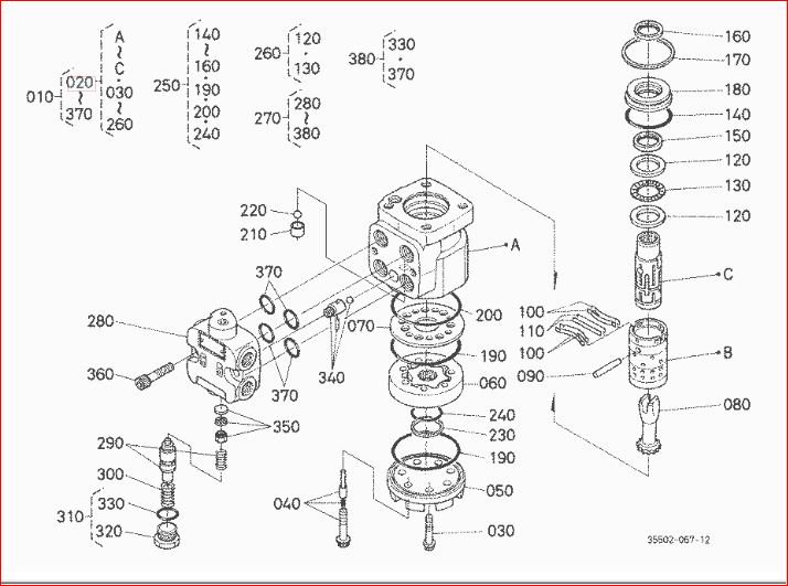

You don't have a conventional steering box on that model, you have a hydrostatic steering.
It's a unit that redirects fluid proportionally to a hydraulic cylinder to control the steering.
There is 2 lines that go in and 2 lines that go out of the steering unit.
If it's leaking it will pump out all the hydraulic fluid so you will need to refill that.
It a fairly complex device that costs $1.3K to replace, so I wouldn't suggest you take anything apart unless you are a very skilled mechanic.
Based on your serial # it can have one of 2 units:
Old Unit serial # <= 24638
New Unit Serial #>=24639
