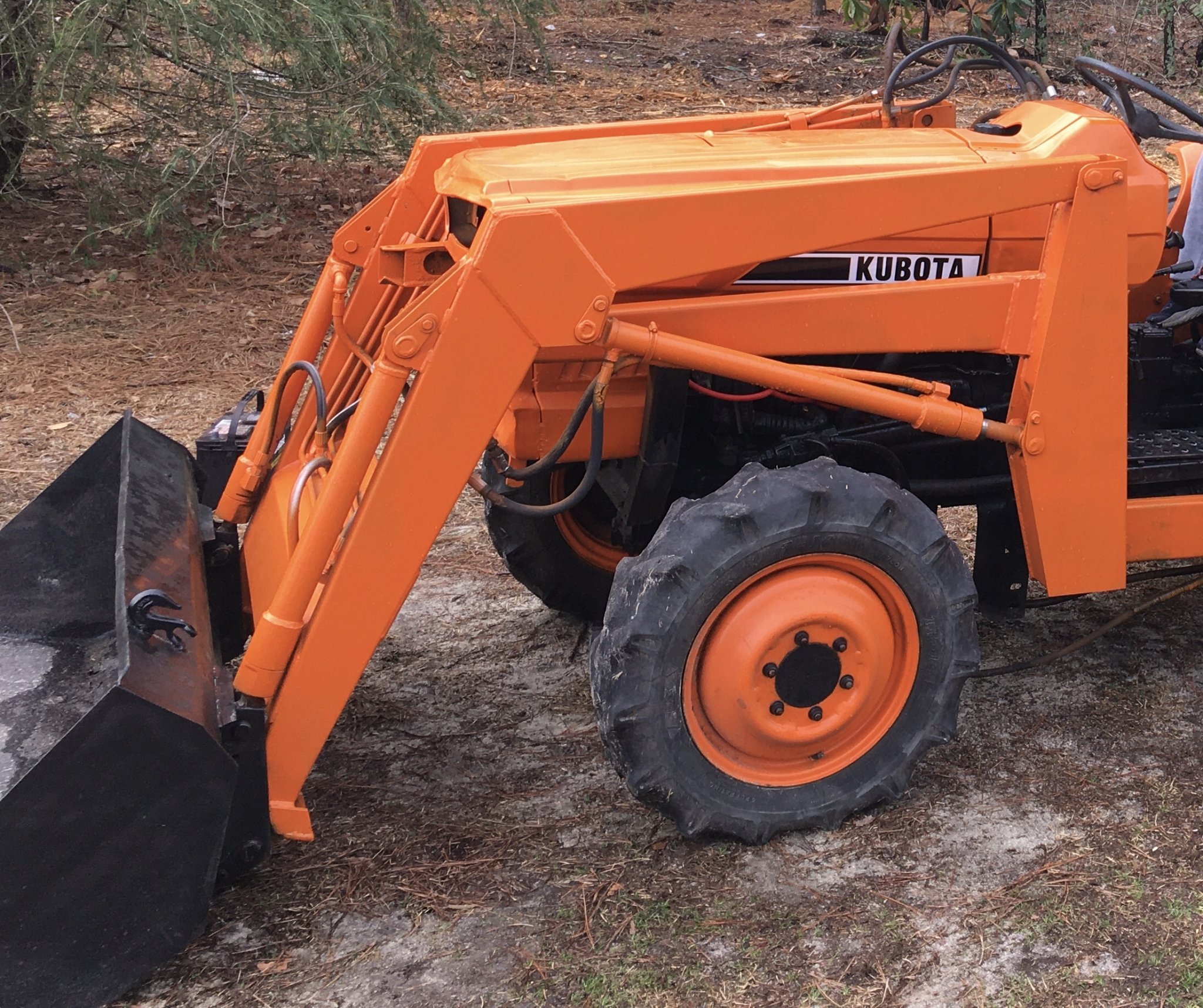

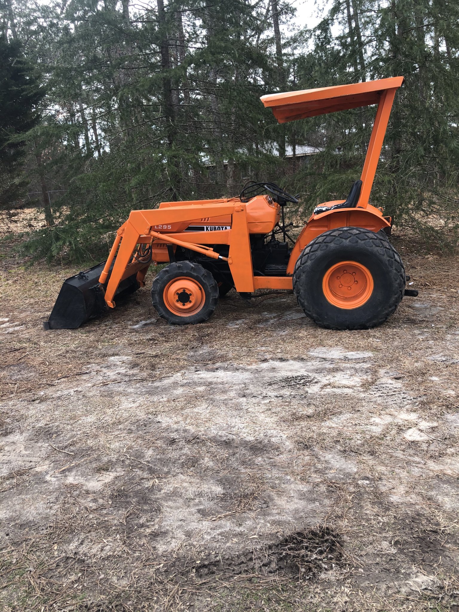

I have a L295DT with a loader. Most of my hydraulic hoses need changed. A couple questions:
1) Does anyone know the loader model and where I can get a manual?
2) a lot of the hydraulic hoses have big droops or what seem to be unnecessary bends/radius. Can I or should I replace with shorter?

I think you have a L1200 based upon the style of hydraulic cylinder I see in your photos.
Kubotabooks.com in the loader section has a manual and here is a link to it.
L1200
The only reason for longer hoses might have to do with removing the loader from the tractor. Shorter hoses will, if anything marginally, improve performance.
