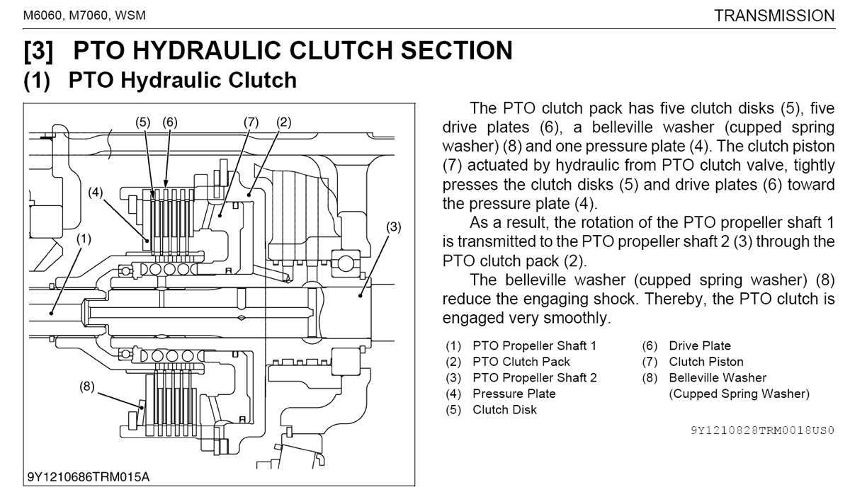

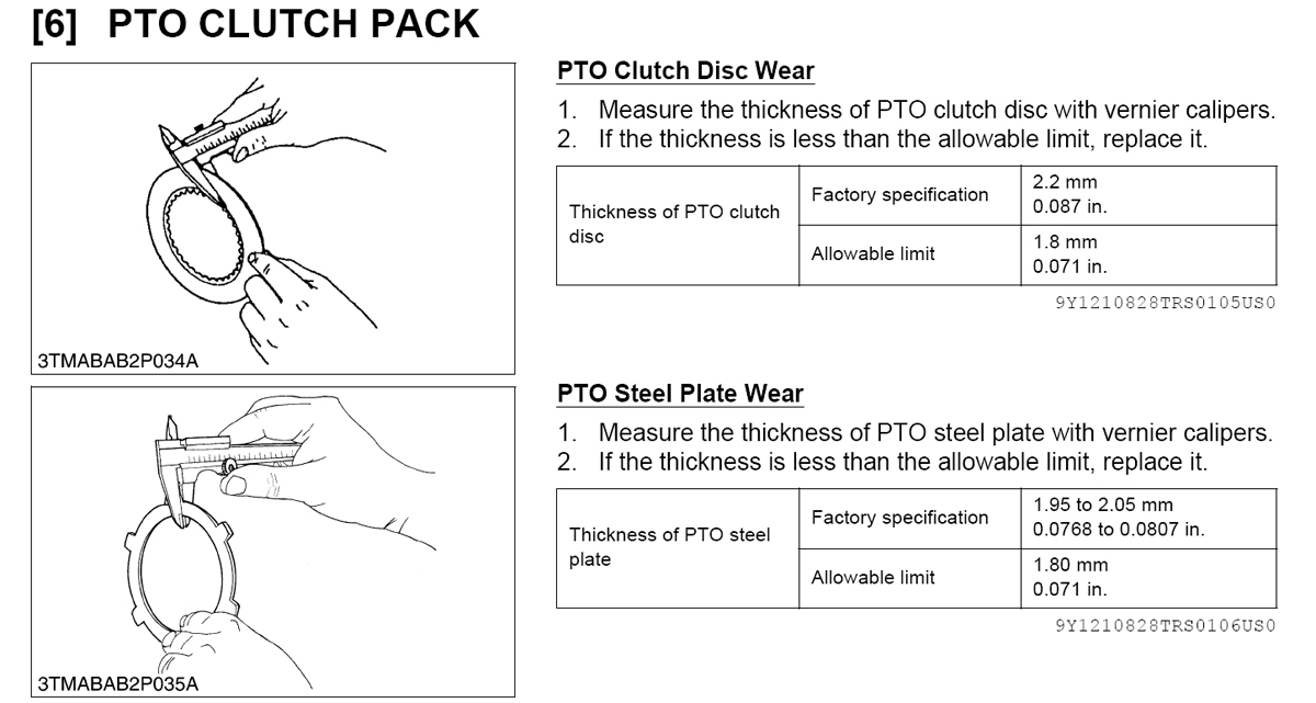

I'm down this rabbit hole at the moment with a Land Pride folding cutter.
The PTO clutch pack consists of clutch disks, drive plates, a bellville washer and one pressure plate. Hydraulic pressure through the PTO clutch valve moves a clutch piston which drives the clutch disks and drive plates together and towards the pressure plate. The bellville washer is there to reduce shock when engaging the PTO. This design has been used for decades and seems to be reliable.
What's cool about the clutch disks and drive plates is that the clutch disks are splined and fit on the PTO clutch input shaft. The drive plates have notches around the outer circumference that fit into notches in the outer cup of the output shaft. If you look at the second screen shot from the WSM you'll see the clutch disk (top) and drive plate (bottom).
So with today's modern tractors, it seems that an overrunning clutch isn't required. The live independent shaft to the PTO clutch pack is driven directly off the engine, and once hydraulic pressure drops enough after the PTO is disengaged, the PTO clutch disks and drive plates can no longer transmit torque out to the PTO shaft that drives the implement.

You're talking about something else entirely. I'm well aware of the benefits of a slip clutch that's on my RCR1884 for example as well as the new folding cutter that I ordered. I'm also familiar with the concept of shear pins and their value in preventing expensive damage. The slip clutch (or shear pin) is there to prevent a huge and "instant" resistive load on the PTO output shaft which would be transferred all the way to the engine. I get that. However, this situation is encountered while the PTO is engaged and when the operator isn't expecting it.
The point about overrunning clutches is that they deal with the engaging and disengaging of the PTO output where nothing is coming to dead stop in the blink of an eye, as is the case if the cutter blades or some part of the spindle hit something immovable. In that situation, the rotating mass of the implement can feed back to the tractor and cause the tractor to move if you don't have an independent, live PTO. With these tractors the PTO shaft is powered off the transmission and not the engine, so if you depress the clutch, the PTO stops rotating.
Part of my process of understanding something is putting it into words and mistakes will be made, but the idea is to eventually get a better and more accurate understanding of the system.
