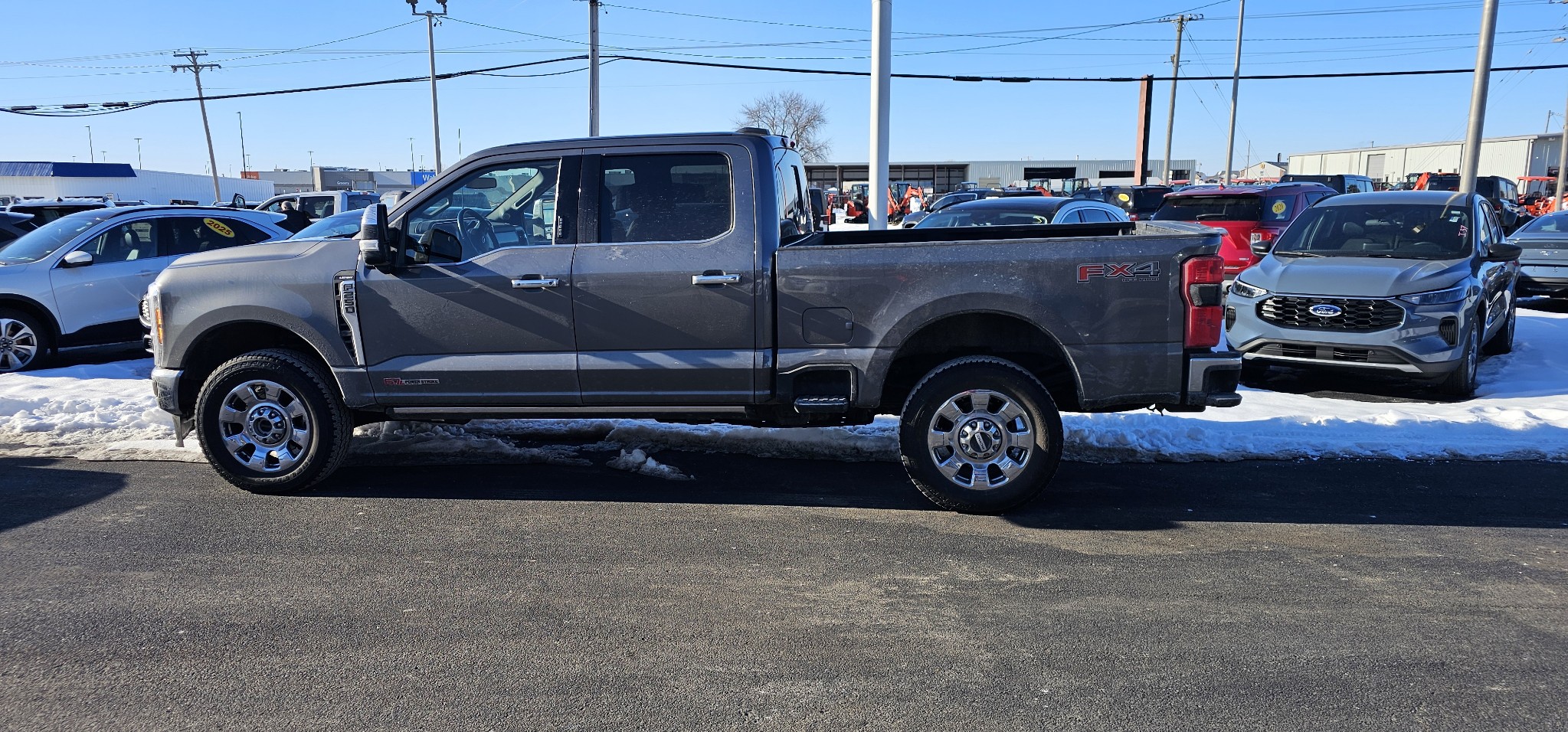

Sorry for the poor explanation. Yes, it has the full trailer tow package and I was looking at what ball/hitch combo to buy. No, not planning on the old fashion bumper pull, just old habits of what we call conventional towing (I think is the proper term). I don't even believe the bumper is actually setup for the old ball to the bumper type connection.
It has the high capacity trailer tow package and the fifth wheel/gooseneck package. The tow package has the upgraded suspension, so it has a GVWR of 11,100, GCWR of 31,000 with the way we have it spec and estimated cargo it can pull 21,340lbs according to Ford online towing calculator based on our VIN and the values we entered for cargo weight.
Most of towing will be local towing around 40 minutes or so. Being in Southern Illinois, no big mountains to worry about. Most of the towing is Spring, Summer, and Fall, with almost no towing in the winter.
Towed a few times in St. Louis and learned a whole new appreciation for truck drivers that do that on a daily basis. I will go over there to the terminal to pick up items, but I would hate doing that all the time.
Picture of it at the dealers before we purchased it.
