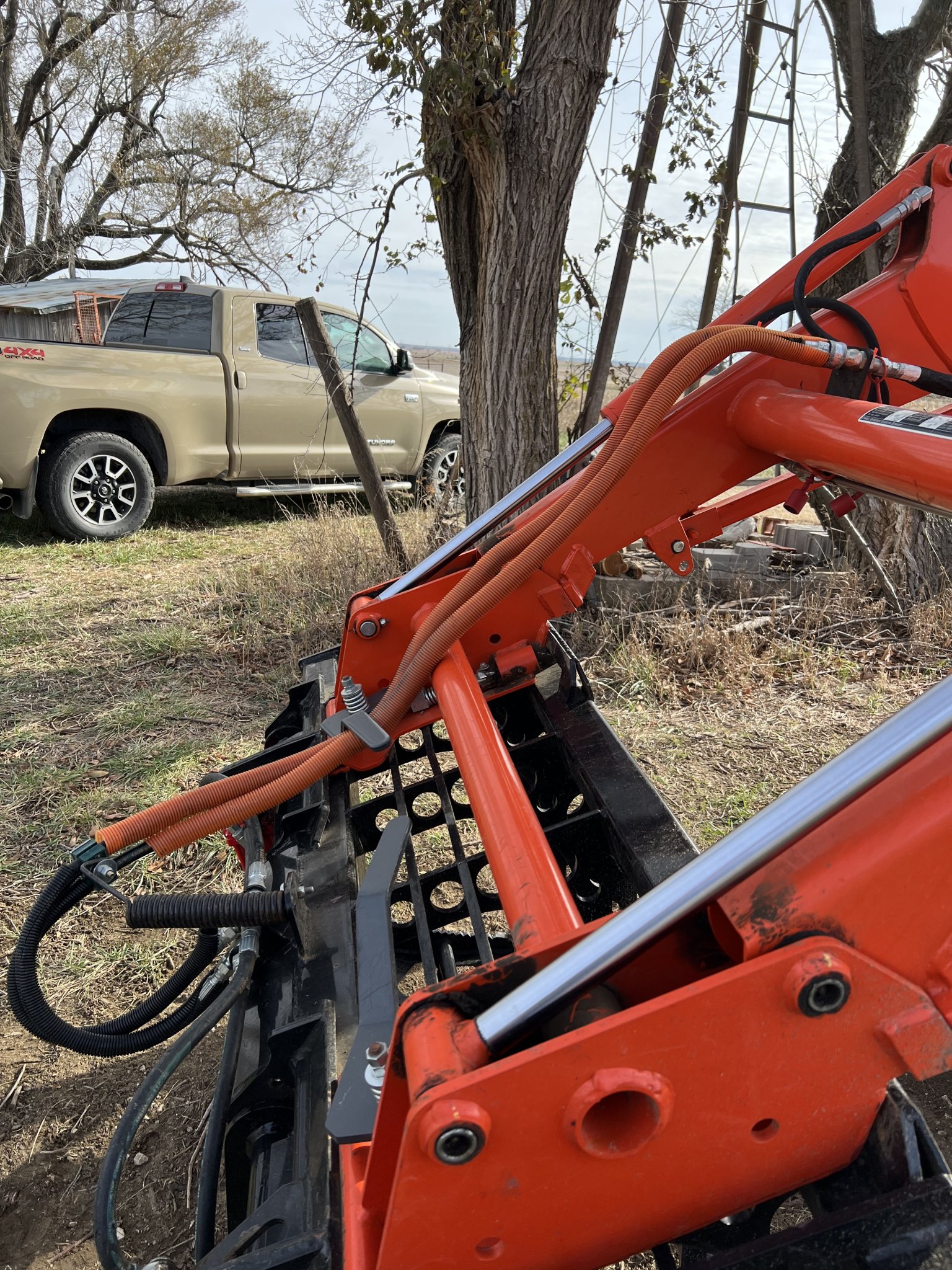

Mine are mounted perpendicular to the loader support. They work great. I have covered the hoses with split wire loom to keep the Hedge & Locust thorns from injuring them. This is an AE Wicked grapple with stock hoses.
This is way I asked the question, I wanted to see how the hoses lay with the different set ups, these are very good images showing the routing, I like the idea of the covers as others have mentioned as well.
