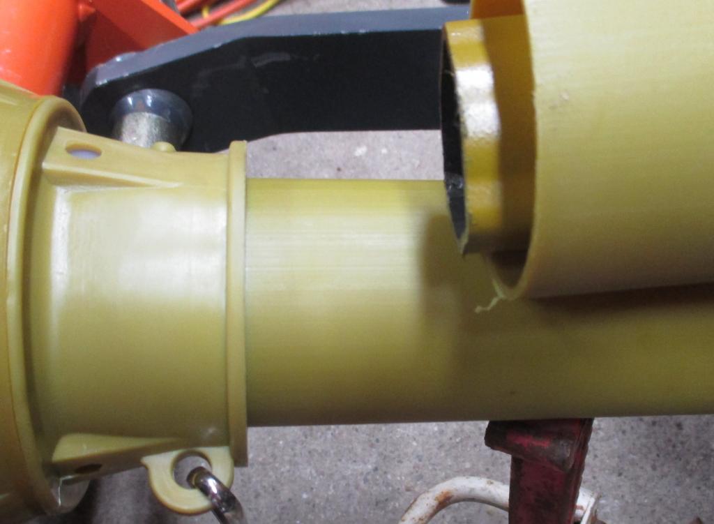

The question I would have is... does the shaft lengthen or shorten...during the raising and lowering of the implement. If 1-3/4” is the shortest distance experienced then you should be OK... But raising the implement...might actually cause binding as the implement is raised.
2,906
3,261
so, you have 1-1/4" of free play before bottoming out? As George posted, I'd leave the PTO off and raise the tiller to full 3pt lift height. Check the distance there. That's where you typically run into issues (with the 3 pt lifted to full height).
The simple way is to just measure the distance from the locking groove of the PTO shaft on the tractor to the locking groove on the implement. Check it while raised, and at operating height.
Many youtube video's on how to measure/cut shafts.
just saw your second post...i think you got it right.
This is what I did with the new to me used snow blower we got. I measured full up and several increments to full down to normal operating level.
Normal use level was the shortest of the measurements. I cut the shaft to give about 2" of free room from the end of the tractor pto shaft. This gave maximum engagement, with enough room to hook up the shaft at normal operating level. Still leaving good engagement at full height.

If it was me I would remove the plastic safety shield and worry about the steel shafts first, then cut the safety shields as much as the steel were cut.
I really don’t understand what the picture was showing though.
